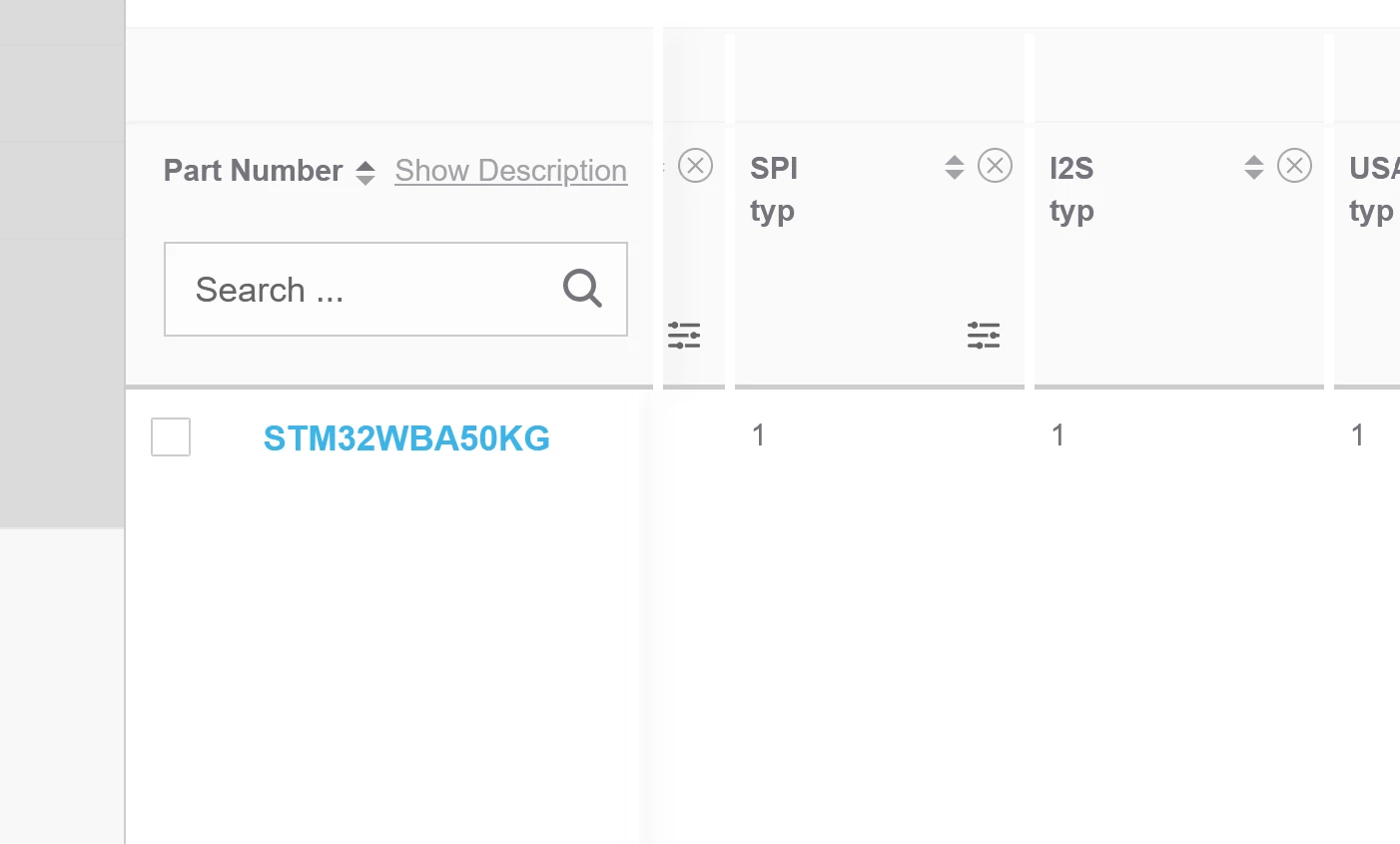

The product page shows that the STM32WBA50KG supports I2S for a serial audio interface. I want to connect a Class-D Amp and cannot find any reference to I2S or SAI in the data sheet or programmers reference manual. Does the processor support I2S?

As you can see on the top of the page 1646 of the RM0493 Rev 5, the SAI is Available only on STM32WBA54/55xx devices. So, the STM32WBA50KG does not support the SAI/I2S.

Understood and I upgraded to the STMWBA54.
Just to be clear, the data in the product selector is wrong and should be corrected at some point, but it's not a problem at this point {see below screen shot}.
