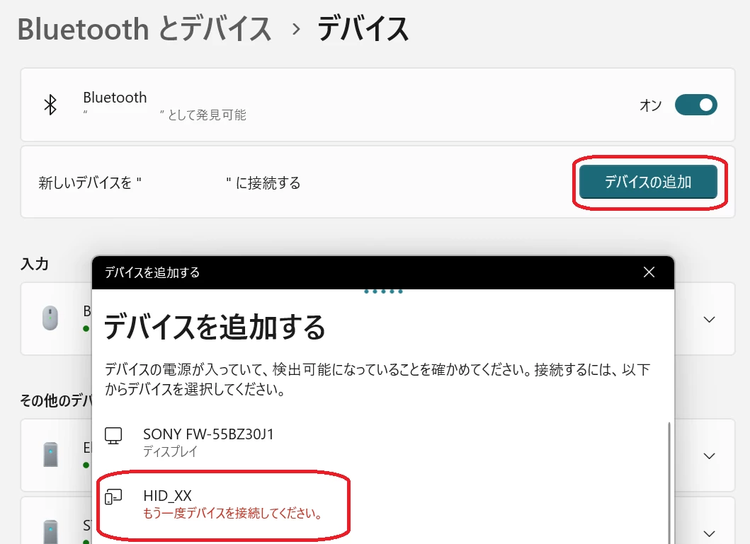

I want to implement HOGP (BLE HID) on an STM32WBA23KE so that it can connect to Windows 11.
I implemented it using the BLE_HID_Mouse sample for STM32WBA55G-DK1 as a reference, but Windows 11 does not recognize it as an HID device (it seems to be failing in some procedure after the Bluetooth connection).
I checked the GATT service configuration by connecting with a smartphone app, and there seem to be no particular problems (although I cannot read the Report Map or HID Information due to BLUETOOTH_PRIVILEGED).
With the STM32WBA55G-DK1, I have confirmed that it can connect to Windows 11 as an HID device and behaves like a mouse.
I have attached the main source files and .ioc file of the STM32WBA23KE project.
Are there any possible causes?

Hello ​@gocchan ,
Check the following resources that may help you in the STM32WBA BLE HID application and the migration from the STM32WBA5 to WBA2:
Also, check the errata if there is a limitation with your device that may impact your project STM32WBA2xxx device errata - Errata sheet.
