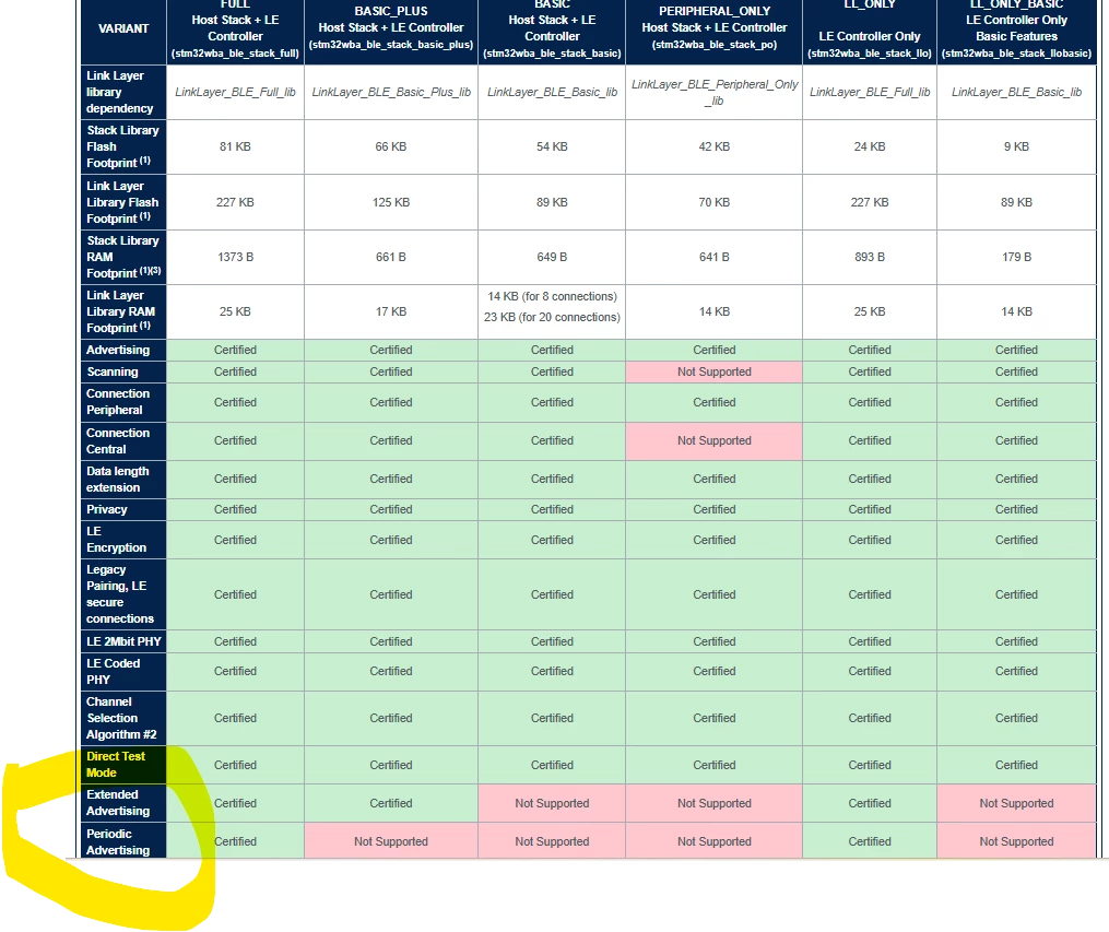

Nov 7, 2025 12:13 PM UTC
What about WBA65?
Also, stack is certified with PAwR?
https://wiki.st.com/stm32mcu/wiki/Connectivity:STM32WBA_BLE_Stack_Integration
Visitor II
Jan 29, 2026 11:06 PM UTC
It will do Periodic Advertising (5.0). It will not do Periodic Advertising with Responses(5.4). It will do Encrypted Advertising Data (5.4).
