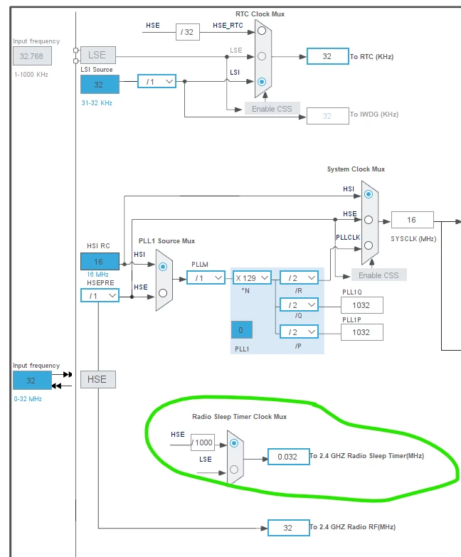

Yes, you can implement a BLE application using the STM32WBA52 without LSE. In this case, you will have to use HSE/1000 as clock source for the radio sleep timer clock. As mentioned on the release note of STM32CubeWBA package v1.4.1, LSI2 is not supported as clock source for the radio sleep timer clock.  Using HSE also will limit you on Low power modes to sleep mode.

- As BLE requires Radio Sleep Timer Clock, for which two options available:
Option-1. HSE/1000: Implemented, tested and found that BLE advertisement works but connection not works.
Option-2. LSE: Implemented, tested and found that BLE advertisement and connection works perfectly.
Seems, LSE is mandatory for BLE operations.

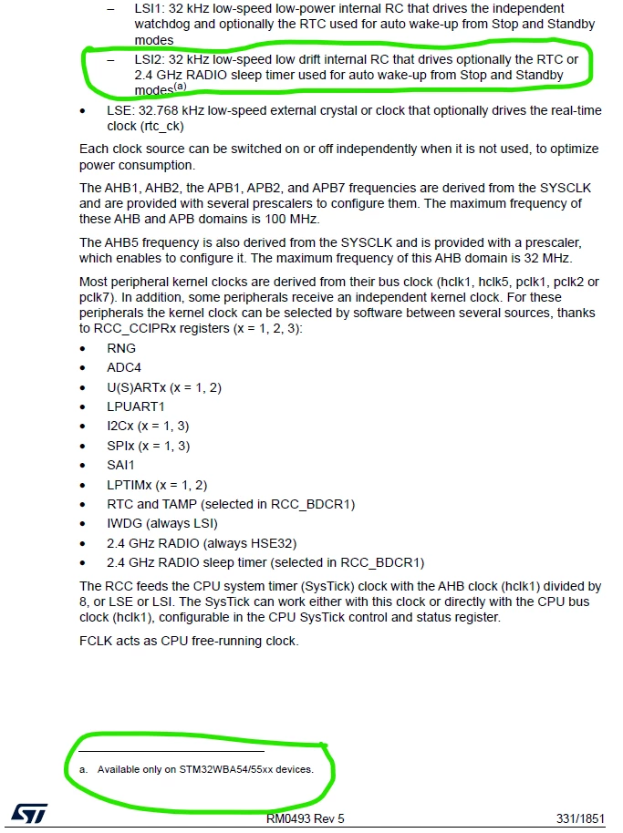

- Further, in reference manual mentioned that LSI2 is available for STM32WBA54/55xx devices,
Means, not available for STM32WBA52xx devices:
- Can you please provide guidance, related to which source require for Radio-Sleep-Timer-Clock,
And how to make BLE working properly, is that further configuration requires?

I confirm there is two valid options to run BLE over STM32WBA52 without LSE.  Both solutions are validated for BLE.
  1. Option #1 : Running using HSE_DIV100
    I do confirm that it is possible to use HSE_DIV1000 for BLE.
PeriphClkInit.RadioSlpTimClockSelection = RCC_RADIOSTCLKSOURCE_HSE_DIV1000;
Of course, using HSE_DIV1000, it is no more possible to mange low_power_mode as HSE must remains always active.
Low power mode must so  be disabled :
#define CFG_LPM_LEVEL (0)
To ease testing of HSE_DIV1000 over CubeFW code example, you may use attached .pdf doc - I tested it on STM32CubeFW code example running over Nucleo-WBA55 board  (tested using BLE_P2P_Server and BLE_HeartRate) code examples.
  • Option #2 :Running using LSI2
Since last CubeFW delivery v1.6, LSI2 usage is now possible.
More details here : https://wiki.st.com/stm32mcu/wiki/Connectivity:STM32WBA_without_LSE_crystal
