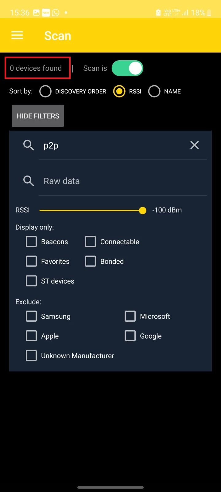

I am using stm32wba55cg nucleo board, and running the example application BLE_p2pServer. While the serial logs of the board show that the device is in advertisement mode, it can not be discovered on my samsung s20 fe, running android 13.
I tried using different advertisement intervals, but no result.
Please help on this.

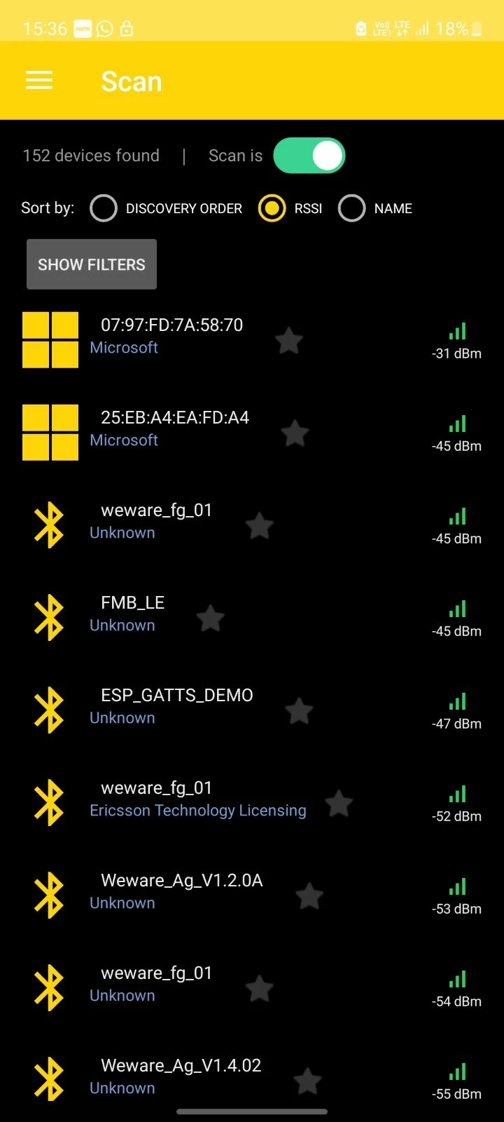

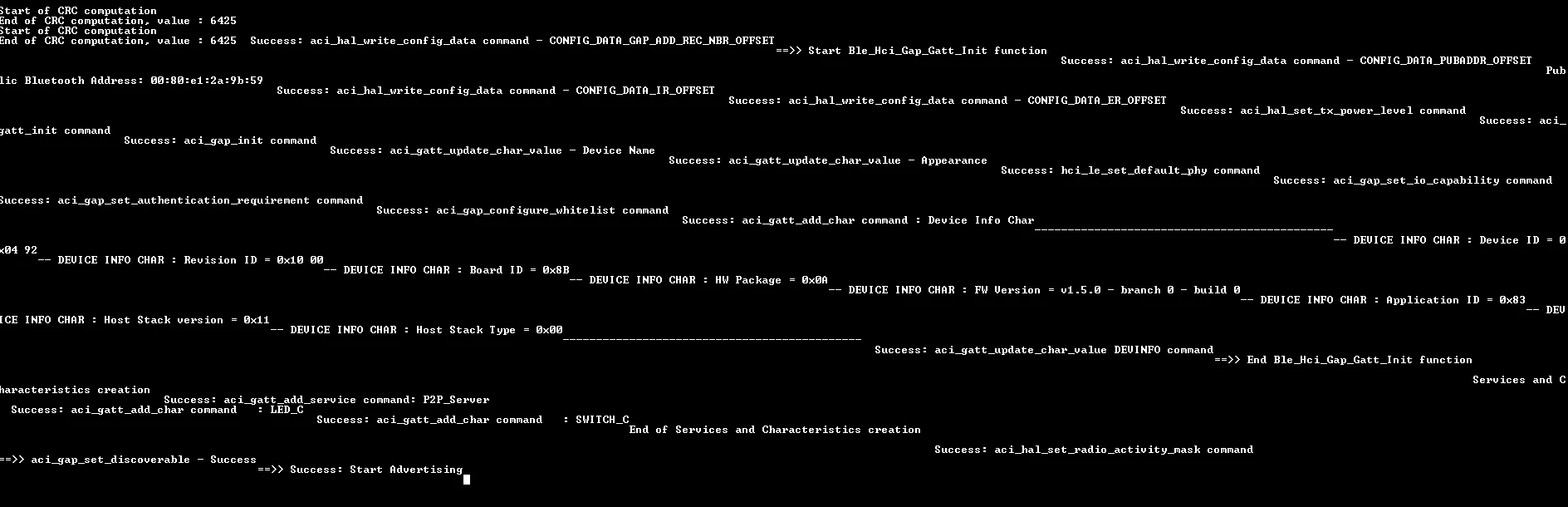

Not just this phone, tried it with 4 other android phones and these werent able to discover
Yes, the phone is able to discover other things advertising. please find the attached screenshot for your reference as follows:
1> Serial logs of the STM32WBA55 nucleo :
2> Screen shot of ST tool box on phone without any filter:
3> Screen shot of ST tool box on phone with "p2p" filter

To make your serial log easier to read, reconfigure the terminal to do a Carriage-Return when it receives a Newline.

I've tested on my side (with android and IOS phones but unfortunately not the same phone that I don't have). and everything works fine. Also, according to the logs you shared, it seems to be working fine. It maybe something not related to the STM32WBA5. I've found this post, maybe is the same issue. You may post similar post on the same forum.
Best Regards.
