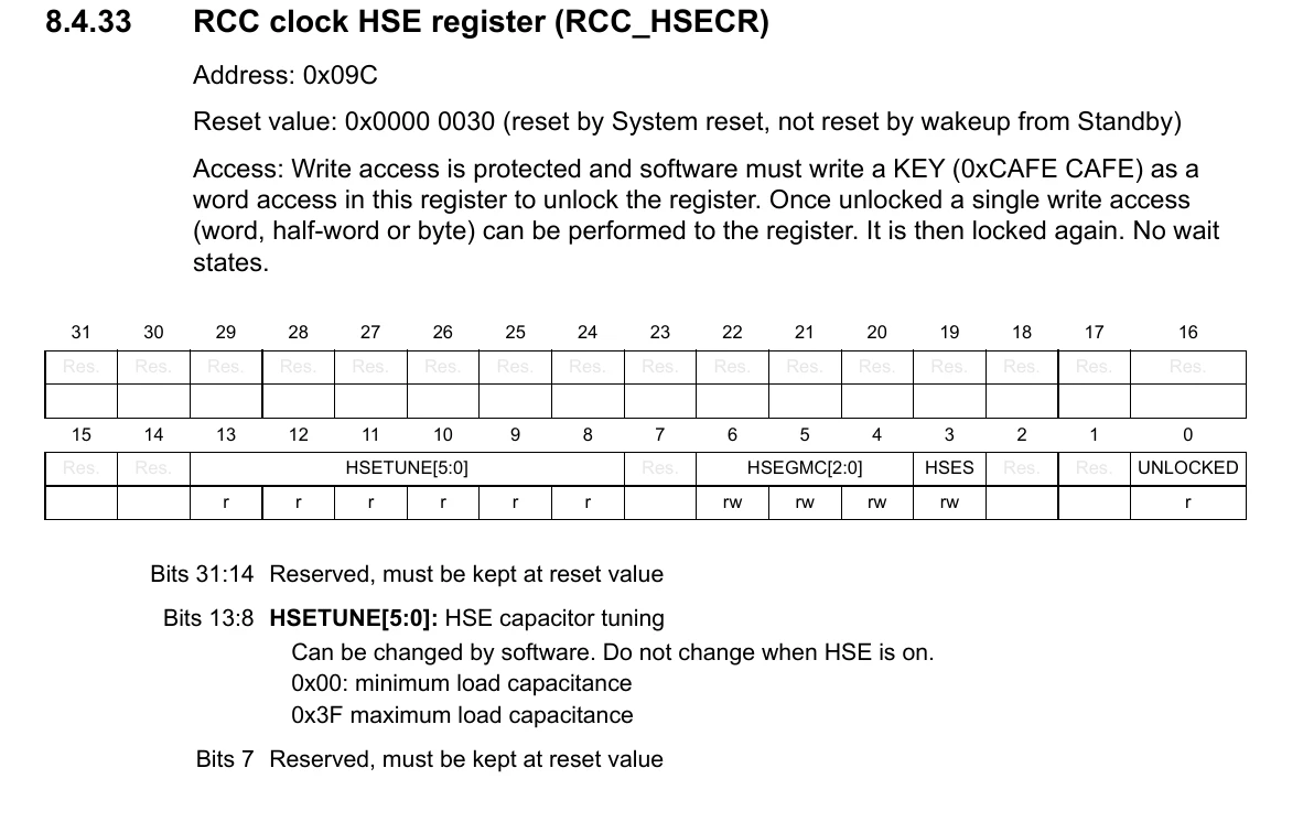

 I know I have to trim the clock using the registers on the STM32 but I was unable to find how the value in the register maps to a specific capacitance. This led me trying every single possible value (0-63) but that made no difference. I have already resoldered a new crystal and a new STM32 so I am now believing the I have a layout issue in my PCB that's causing the crystal to not start.

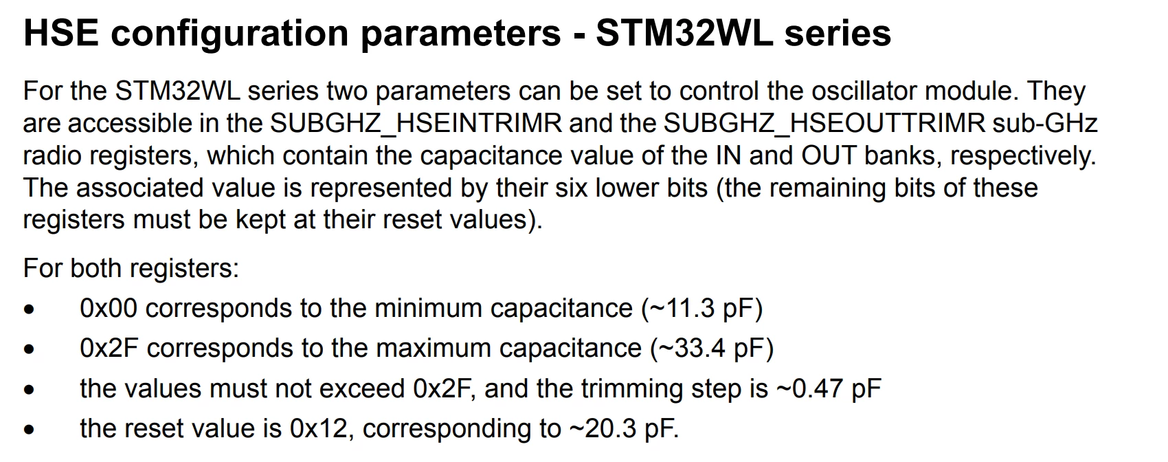

I saw the section in AN5042 about the HSETUNE[5:0] register already. What I meant by "a specific capacitance" was how the values, 0-63, correspond to a capacitance in pF. (Like how its stated for the STM32WL) Pablo04_0-1749092003158.png

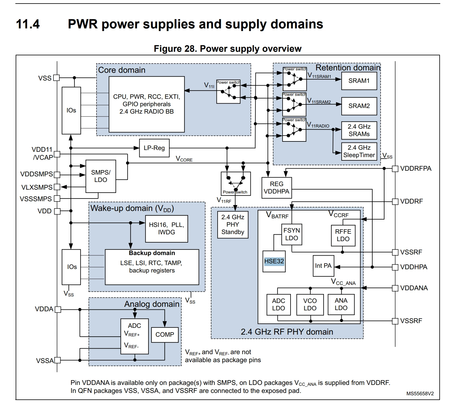

Anyways, from your comment about power, I double checked my schematic and realized I made a dumb mistake by forgetting to power up VDDRF which powers the HSE.
I haven't been able to add a bodge wire yet but I'm assuming it will fix my problem.
-> Refer to AN5042 for the HSE trimming procedure.
ok, just see rm :
(I dont have this chip...) Is there nothing to set the HSE in Cube ?
If not : set a value with "average" values , i would try :

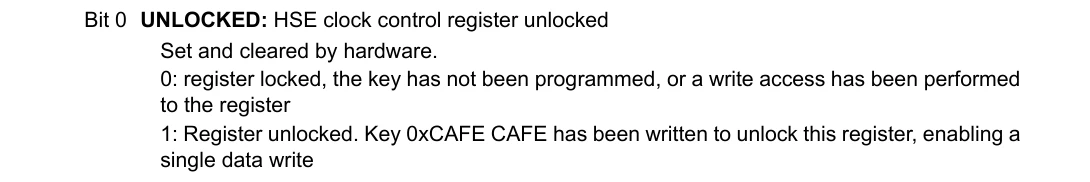

- before the start of the hse
- unlock register
- write 0x2FA0   (just guessing...try. or 2FF0, max drive) to RCC_HSECR
-> read AN2867 “Oscillator design guide for STM8S, STM8A and STM32
