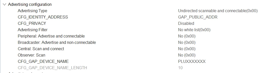

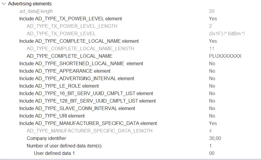

STM32WB5MMGHx stops advertising after resetting from power loss.
I’m using a STM32WB5MMGHx module on a battery powered device. When the module loses power due to low battery or the battery being removed it does not advertise after regaining adequate power. Only after restarting or reflashing the wireless stack does the module begin to advertise again.
Here are my cube configurations for BLE:
How can i solve this?

Hi, @Remy ISSALYS
The power supply is stable at a healthy voltage for this module.
Can i maybe solve my problem by force resetting core 2 at power on?
