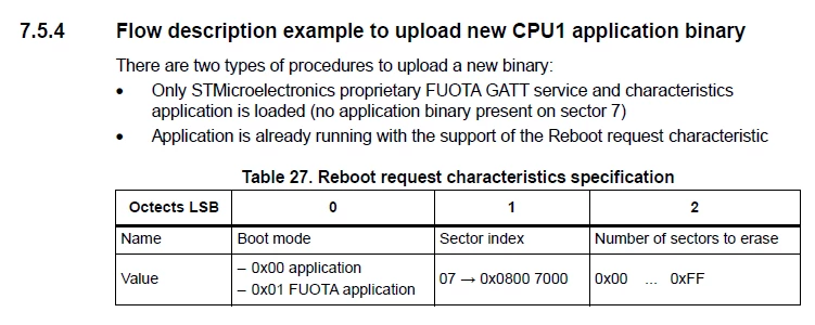

So I found this info,
When my device is up, it has the option "OTA Reboot Request" when I use ST Ble Toolbox,
I write Hex "000702" but nothing is happening
My code has
  case CUSTOM_STM_BOOT_REQUEST_EVT:
   *(uint32_t*)(SRAM1_BASE) = *(uint32_t*)pNotification->DataTransfered.pPayload;
   NVIC_SystemReset();
   break;
Do I understand the logic is OTA loader will use the information from SRAM1_BASE (which is define at 0x20000000UL, to erase my 2 sector starting at 0x08007000?
#define SRAM_BASE       (0x20000000UL)/*!< SRAM(up to 256 KB) base address */
#define SRAM1_BASE       SRAM_BASE         /*!< SRAM1(up to 192 KB) base address */
If I used the programmer, and manually erased 2 sectors starting from 0x08007000, after the power cycle, my device always comes up with STM_OTA which is the OTA loader application was loaded at 0x08000000.
Please suggest where should I need to double check or my errors.

In custom_app.c:
 case CUSTOM_STM_OTA_REBOOT_REQUEST_WRITE_EVT:
 /* USER CODE BEGIN CUSTOM_STM_OTA_REBOOT_REQUEST_WRITE_EVT */
 	APP_DBG_MSG("\r\n\r** OTA Reboot event!\n");
 	/* Write reboot reason at 0x20000000 (SRAM1):
 	 * Boot Mode: 0x00-> User Application (0x08007000), 0x01-> OTA application (0x08000000)
 	 * Sector index: 0x07 (7 sectors is the first to be program)
 	 * Number of sector to be erase (4K granulation): Filesize/4K + 1
 	 * Total: 3bytes (octets).
 	*(uint32_t *)SRAM1_BASE = *(uint32_t*)pNotification->DataTransfered.pPayload;
 	NVIC_SystemReset();
 	while(1);
 /* USER CODE END CUSTOM_STM_OTA_REBOOT_REQUEST_WRITE_EVT */
 break;

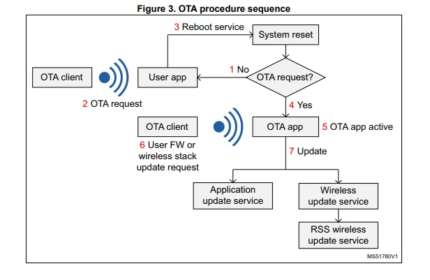

You may see the OTA procedure describe in this figure
AN5247 may be usefull for you.
