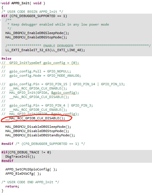

2. My program can run normally only when it is downloaded for the first time. When it is powered on again, the demo does not work properly.
3. If I add APPD_Init() in the MX_APPE_Init() function and the CFG_DEBUGGER_SUPPORTED is 0, I can collect data from the MAX30112 normally (it is also normal to restart after a power outage) and send it via Bluetooth. But there is no news about MAX30001 at all, and I am not sure what the problem is.

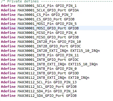

4.For this reason, I went to check the APPD_Init() function, and I found that the program with the greatest impact was __HAL_RCC_GPIOB_CLK_DISABLE() (shown in the picture on the upper). Commenting out this statement, I will only download the program normally for the first time; without commenting the statement, I can only receive data from MAX30112 via Bluetooth, MAX30001 will fail, and it will be normal for the second power-on. The picture below shows my GPIO settings.
5.Additionally, I used SWV for debugging (without adding Bluetooth), just wired output, and it worked normally.

Hi Lep,
I wanted to know why you have initialized the GPIO A 11 pin. May I know its purpose.
Lep
LepAuthor
Senior
May 10, 2024 10:56 AM UTC
Just a red led.Mainly used to indicate some functions, of course this part can be turned off.
