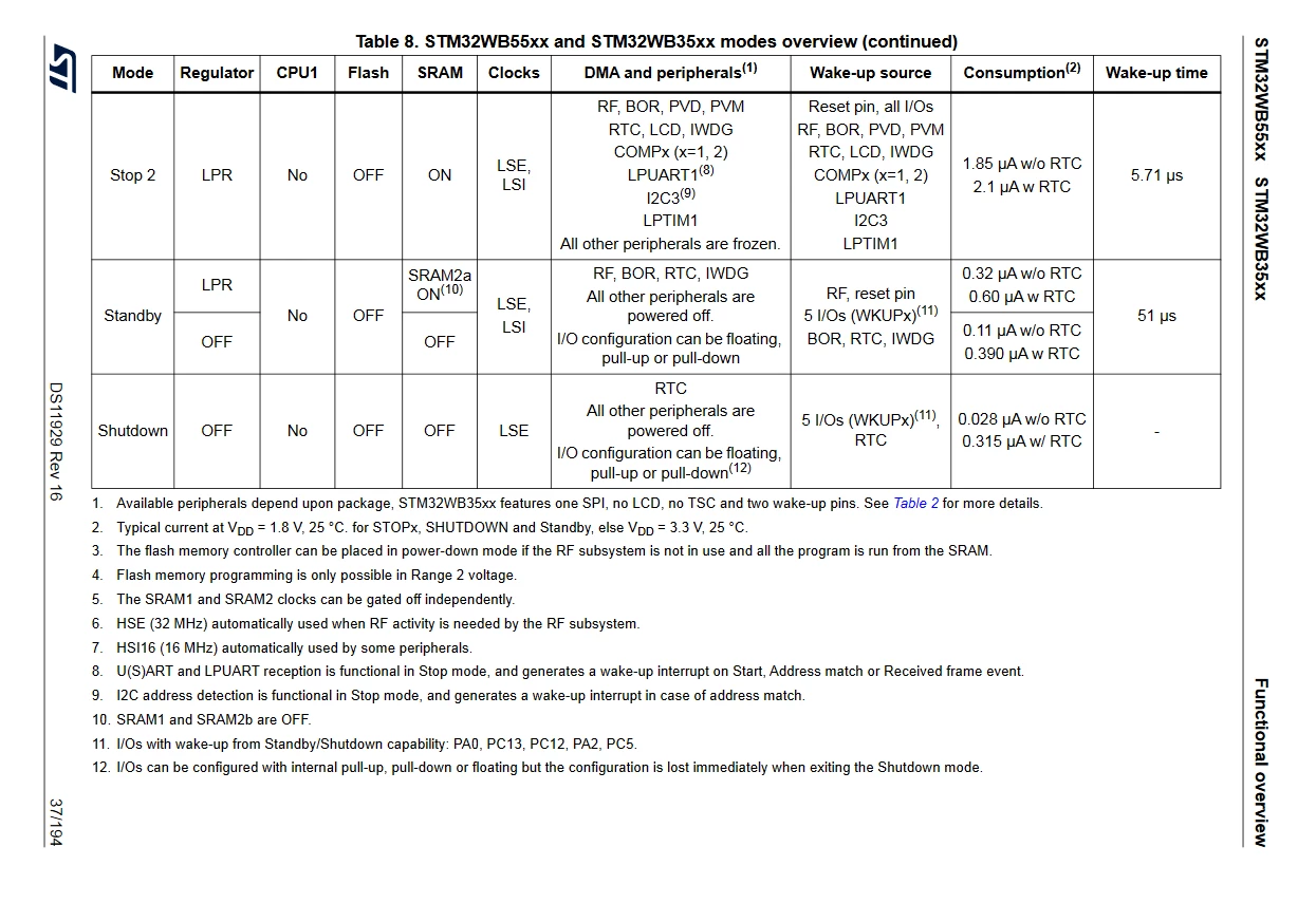

HI, Regarding STM32WB5MMG .
It says its also supports:
- Ultra-low-power modes for battery longevity
But how low? I can't find how much it consumes in STOP MODE 2.
Is it written somewhere?
Did anyone get to measure it?
Is there a board that has this chip only without any peripherals I can measure current on?

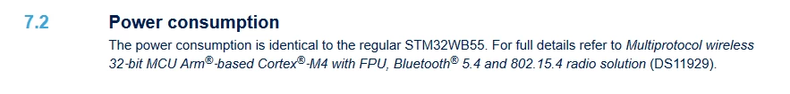

in datasheet https://www.st.com/resource/en/datasheet/stm32wb5mmg.pdf it says

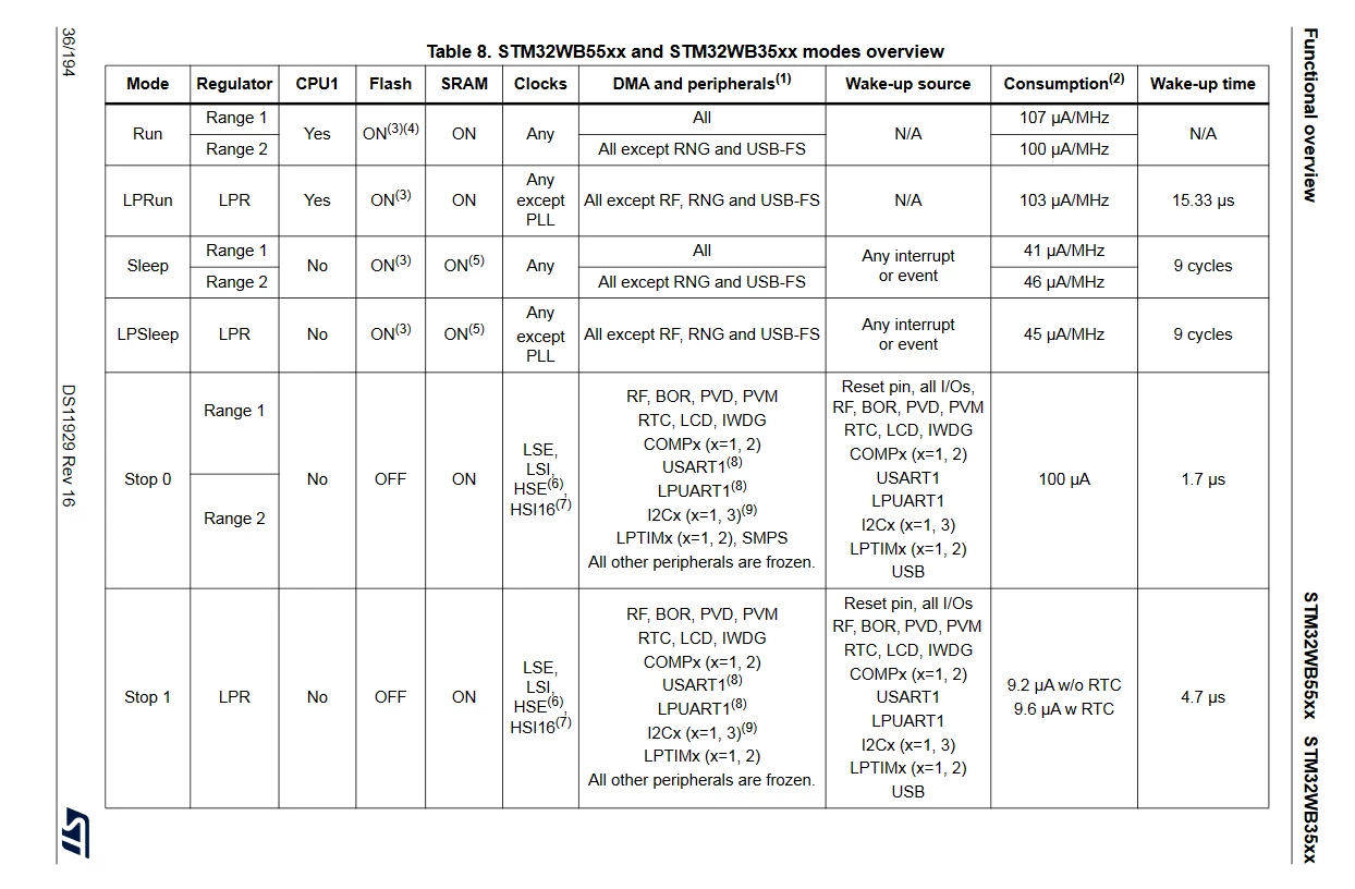

in WB55 datasheet https://www.st.com/resource/en/datasheet/stm32wb55ce.pdf on page 36/37 you can find :
