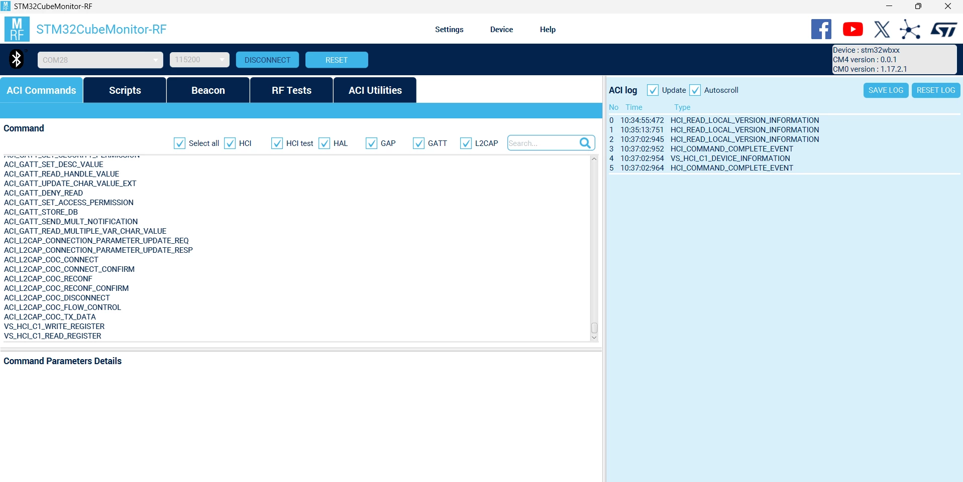

We are using an STM32WB5MMG in a product, We needed to run a few BLE tests for compliance needs and came across the BLE transparent mode to help with BLE tests.

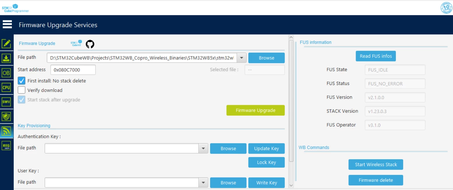

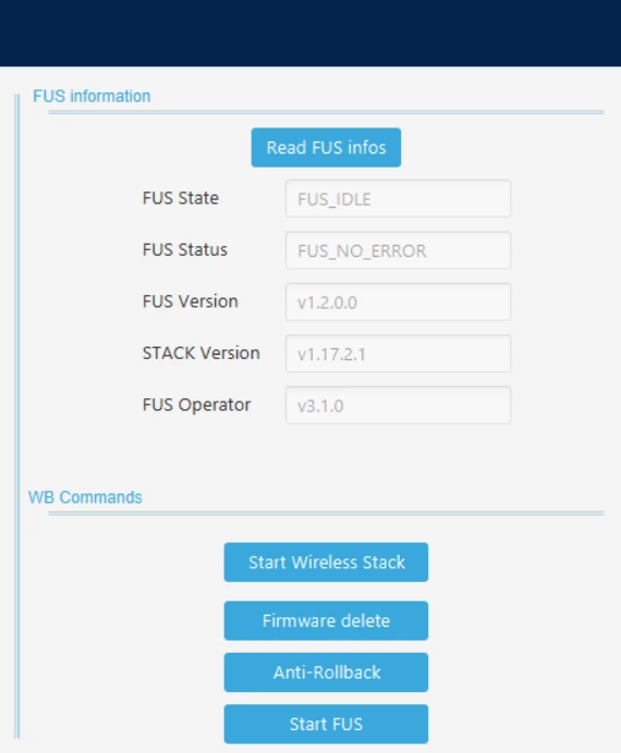

In accordance with the ReadMe under BLE_TransparentMode inside STM32WB5MM-DK, we have undertaken the following steps
  • Updated FUS to stm32wb5x_FUS_fw.bin at 0x080EE000
  • Updated soft device with stm32wb5x_BLE_Stack_full_extended_fw.bin to 0x080C7000
  • Modified BLE transparent Mode to change USART pins being used to PA9 and PA10 though Cube MX
Updated FUS and Stack
Updated VCP_TX and VCP_RX

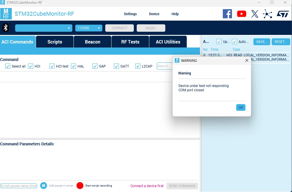

The CubeMonitor-RF software refuses to connect with the device however
Unable to connect
No changes are done to the transparent mode example with the exception of UART pin update. ioc file PDF attached

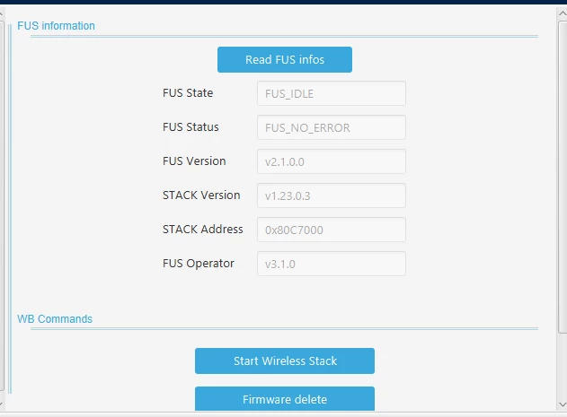

I have already attached a screenshot of the CubeProgrammer window in the thread above, showing my FUS and BLE stack updated correctly.

transparent mode application requires stm32wb5x_BLE_Stack_full_extended_fw.bin.
You can find more information about FUS on our Wiki page.
STM32WB Firmware Upgrade Service - stm32mcu
I tested the example project with same stack version, and it worked fine. However, I also got a message that the device is not responding. I connected the board to STM32CubeProgrammer and clicked on "Start wireless stack" and then I downloaded the application again and it works fine. Can you please try it again with the steps I mentioned? Thank you.

Thank you for the links, I am aware of the stack requirements and had setup the device with the appropriate Stack
I also updated the Cube Programmer to the latest version
Like stated initially
  • Used the binaries shared by you

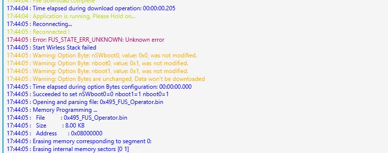

The code unfortunately is still not connecting in spite of starting the Wireless stack like suggested
When I started the Wireless stack manually I also noticed in the cube programmer logs the wireless stack failing to start, could this be the cause?
Like stated before all the examples work fine with older V1.2 FUS and corresponding V1.17.1.1 wireless stack
I am inclined to believe that the way I have setup the FUS / Wireless stack could have some issue since other examples such as Heartbeat also do not appear to be working.
Would it be possible to please verify on your end if your FUS and Wireless stack match mine? I have zipped the FUS, Wireless stack and the App Binary(Same as the one you shared) for you to confirm, logs from Cube Programmer added

I'm using the same versions. After downloading the application, please try to reset the board.
I had to reset my board before connecting to STM32CubeMonitorRF.

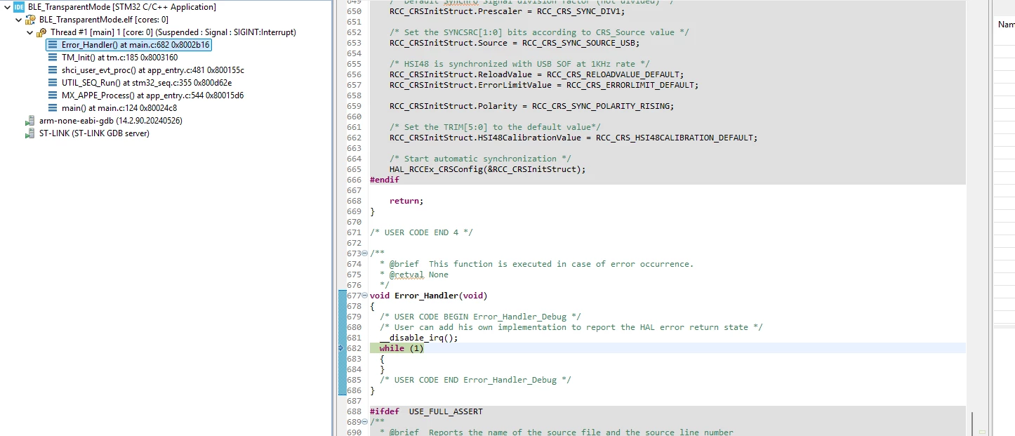

Also, can you please try to download the project directly from STM32CubeIDE?
Thank you.
Best regards,
Filip Kremen
Jul 30, 2025 1:52 PM UTC

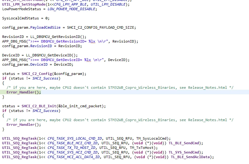

I tried downloading the example project directly without any modifications though CubeIDE and discovered that the device is entering a hard fault
Like I still suspected, there could be something wrong with my FUS/Soft-Device Binaries

vishalkeshavamurthyAuthorBest answer
Aug 5, 2025 1:23 AM UTC
Hi Filip,
On the fresh boards, the problem was because of not having started the wireless stack. It is now resolved
Using the latest version of cubeProgrammer helped with not having to put addresses in manually
I am yet to work on the older boards and will post an update once I revive them
Thank you for all the help!
