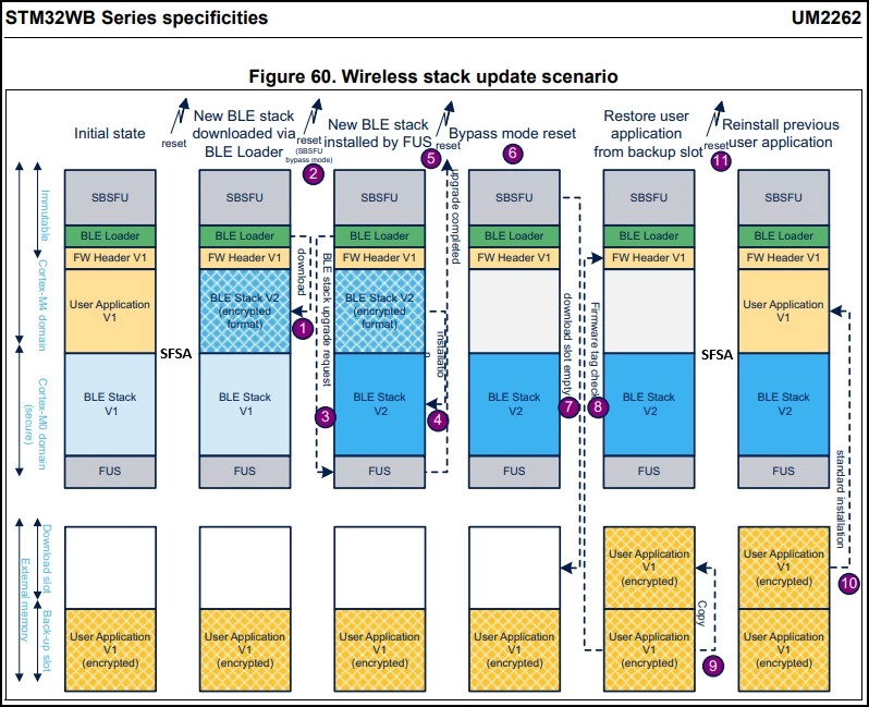

We are working on a project that includes a STM32WB5MMG in a custom board and we would like to update via OTA our firmware application, as well as the BLE stack and FUS. Our project is based on the P-NUCLEO-WB55.Nucleo 2 Images. This project defines two regions (slots) in the flash, one used to store the firmware to run and the other as a storage area for the new firmware image sent via OTA. The question here would be if we update either the BLE stack or FUS if they also have a separate storage area beyond the SFSA address (the start address where the current stack and FUS are stored) or if a flash region between the end of slot 2 and the SFSA address must be reserved as temporary storage for the new stack/FUS image.

I think this illustration could help you to understand how OTA is managed with SBSFU (from User Manual UM2262):
As you can see, the new wireless stack (or FUS, it is the same) will erase your user application in Flash.
So, at the beginning, the new wireless stack (which is encrypted) is not located in the secured area, but below the SFSA address (I've added "SFSA" on the illustration). Then, the FUS will detect the new image and handle the installation (the FUS modify the SFSA value during the operation).

I have a couple questions here: will the BLE_loader always store the new BLE stack at the beginning of the user application area, thus deleting the entire user application, or can this be configured somehow? The thing is in our project we do not have an external flash to store a backup of the user app. If it is mandatory to delete the user app, would still be possible to download it again after downloading the new BLE stack (although being inefficient)?

The illustration is indeed a bit misleading on this point.
But in UM2262, the paragraphe just before the illustration is quite clear (in the link shared in my previous message - page 97):
Thus, the download area for the new wireless stack (or FUS) is not at the beginning of the active slot, but at the end, just before the SFSA.
The scenario shared in my previous message is describing an example available in the SBSFU package (which is indeed using an external flash).
But if your user application is small enough, and depending on the BLE stack used (size are different), then external memory is maybe not needed.
So meaning that if the user app is small enough, then it is not erased by the new wireless stack (and the backup slot is not needed).
STM32WB5MMG is 1024kB of Flash, a portion is occupied by the FUS (48kB) and the SBSFU itself (about 85kB according to Build Analyzer with the BLE_ota).
So, at the end, it gives you 891kB to fit the others slots (download / active / wireless stack).
