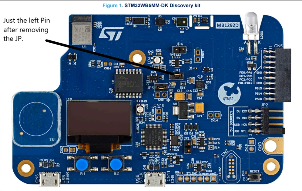

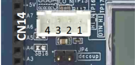

To connect the STM32WB5MM-DK to the X-Nucleo-lPM01A, you have to:
  • Remove the JP1 of the STM32WB5MM-DK.
  • Connect the Pin 1 of the CN14 of the X-Nucleo-lPM01A to a GND pin of the STM32WB5MM-DK.
  • Connect the Pin 3 of the CN14 of the X-Nucleo-lPM01A to the mentioned PIN (take a look at the second screenshot) on the JP1 of the STM32WB5MM-DK.
Best Regards.

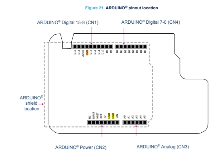

Is there an available pin or do I need to solder one?
STTwo-32
March 20, 2024
Hello @DS.4

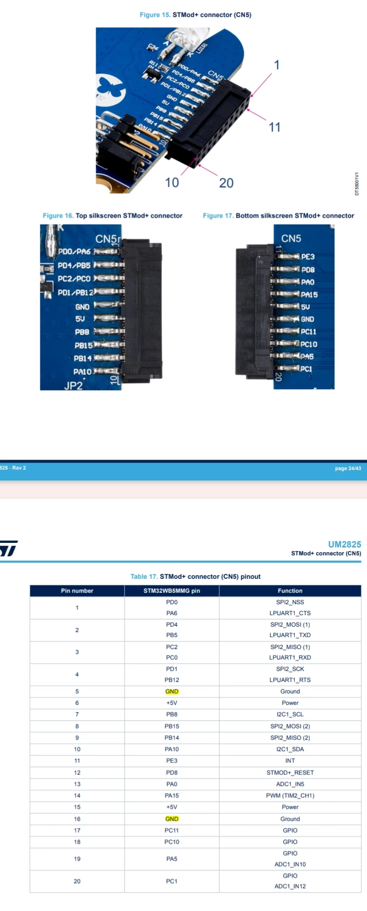

There is GND pins on the Arduino connector:Screenshot_2024-03-20-13-22-37-90_e2d5b3f32b79de1d45acd1fad96fbb0f.jpg
And also, on the ST Mod+ connector:
Best Regards.
