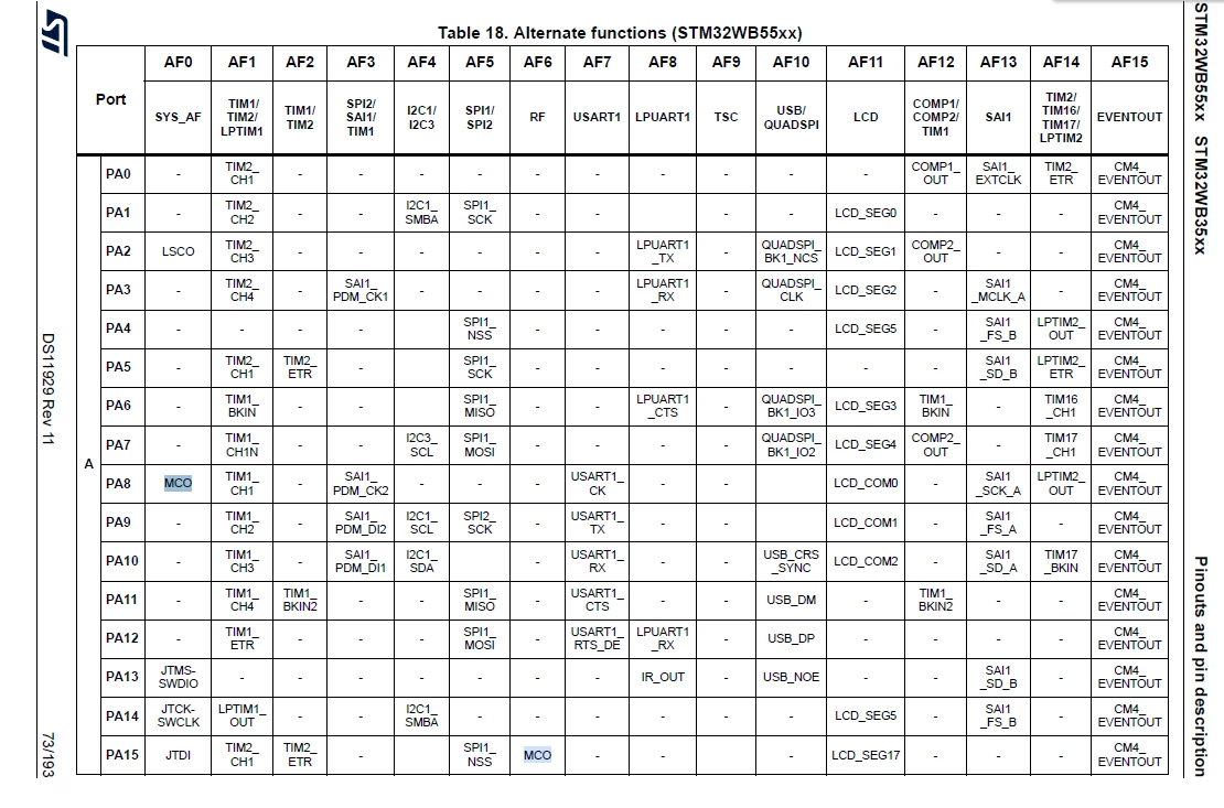

STM32WB55xx: What is the difference between SYS_AF and RF alternate functions?
  • May 30, 2023
  • 0 replies
  • 783 views
According to the Datasheet, MCO on the dual core WB chips is available as an "SYS_AF" and an "RF" alternate function. Does this has an impact if I want to use them from the main core?
