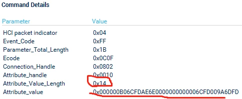

STM32WB55RGV6 What is the maximum payload per notification (BLE server)? How do I need to modify the program?
I want 120bytes per notification,
I want 120bytes per notification, but I can only reach 20bytes with stm32cubemonitor-rf monitoring.
0693W00000UoVm1QAF.png​

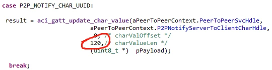

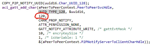

The following picture is what I mainly modified in the program:
Am I going wrong somewhere?

The maximum payload per notification is 251 bytes without fragmentation and you can reach 512 bytes with fragmentation mechanism.
After the connection you should use aci_gatt_exchange_config command to perform an ATT MTU exchange procedure in order to be able to send notification with size near to ATT MTU value set in app_conf.h
