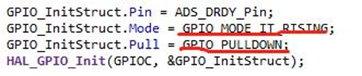

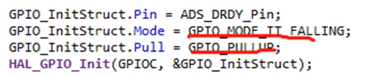

STM32WB55RGV6 GPIO pin configuration ADS_DRDY_Pin is PC11. When I change GPIO_MODE_IT_RISING to GPIO _MODE_IT_FALLING, my ble server can not work normally. Rising is ok, but I can't find my ble device(in falling).
0693W00000SwBb6QAF.png0693W00000SwBbBQAV.pngADS_DRDY_Pin is PC11. When I change GPIO_MODE_IT_RISING to GPIO _MODE_IT_FALLING, my ble server can not work normally. Rising is ok, but I can't find my ble device(in falling). Thank in advance.

Once again, is the code FULLY working with rising edge? Could you please test it again? Is there anything else you have changed?
Also, where do you call UTIL_SEQ_Run() if the last code-image is the main loop?

so the ADS_DRDY is some external signal? Could you please give us more information about this?
Also, why have you changed the pull-down to pull-up?

It's no pull, the picture is wrong.
When I use raising edge external interruption, all is well.
When I use falling edge external interruption, the led can toggle, but I can't find my BLE device (BLE can't work). Can I think the cause of my problem is on the bluetooth side?
​If so, I still don't know how to fix it.

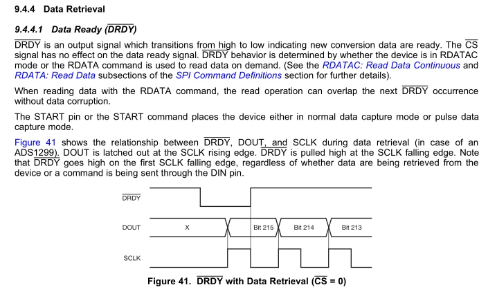

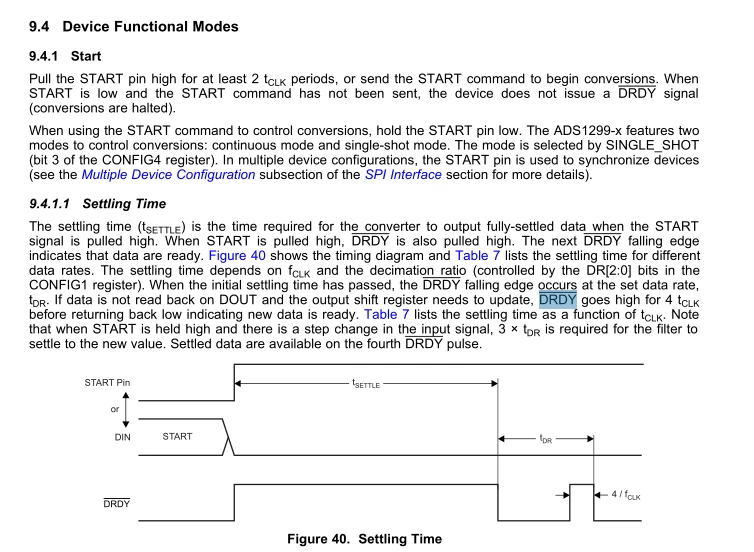

The ADS_DRDY signal are as follows(ads1299 datasheet):0693W00000SwDdOQAV.png0693W00000SwDeCQAV.png​
