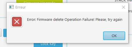

I also have an error when trying to use the "Firmware delete" option:
I already tried to mass erase the chip, already tried to flash previous FUS version, nothing worked... I always have the FUS_STATE_IMG_NOT_FOUND warning.

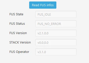

This is my current state:
I have no read protection (option byte set to AA).
I am using CubeProgrammer v2.14.0 and STM32Cube_FW_WB_V1.23.0.
Support would be appreciate to unlock my device ... Already saw some similar posts, but none of them were helpful for me.

Issue solved after switching to latest STM32CubeProgrammer version (2.20.0)
