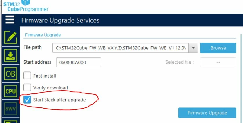

After receiving the board for the first time, I wrote Middleware BLE of STM32_WPAN at STM32CUBE IDE, and communication with my mobile phone's ST BLE ToolBox was very good.
However, after upgrading the stack using STM32 CubeProgrammer, P-NUCLEO-WB55RG cannot be found in ST BLE ToolBox.
The picture below is the stack information at the time it was initially received, and the following picture is the stack information I updated.
0693W00000LvhQZQAZ.jpg<default stack - work ble >
0693W00000LvhQoQAJ.png<updated stack - do not work ble>
Can I get some help?
Or can I get the same version of the Stack as when I first got it?
Thank you very much.

Hello, thanks for your reply. This problem is resolved.
After stack update, start the stack via SWD CLI. then it's resolved.
I have one more question. Is there no way to start the stack at the STM32Cube Programmer GUI?

Remi QUINTIN
Mar 26, 2022 8:37 AM UTC
Yes you just have to check the "Start stack after upgrade" button at the time you program the wireless stack with CubeProgrammer.. See attached image.
