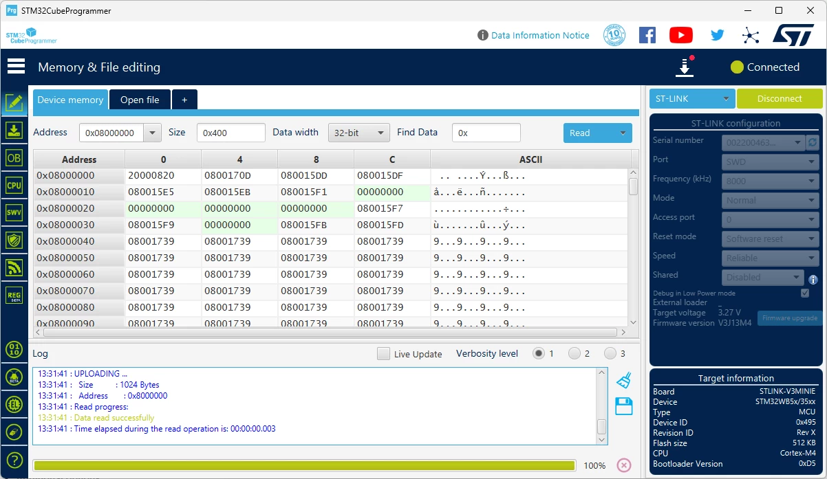

When I try to program it via STLINK-V3 (official, not the clone) it cannot access the MCU and says "No STM32 Target Found".

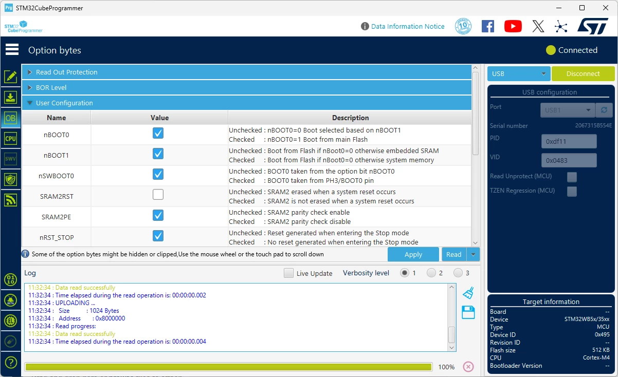

I've connected the MCU USB to my computer and showed that the MCU is in DFU Mode even though BOOT0 is pulled LOW.
Another strange thing is that Option bits are assigned strangely.
I've uploaded the code in the attachments via USB DFU mode and the Code has worked perfectly.
However, I cannot program it again even via SWD or DFU which is very strange behavior.

I've figured out where is the problem.
I didn't connect the VCC pin in the STLINK-V3 to my Target +3V3 Rail.
So the Target Voltage always shows Zero.
When I connected the VCC pin to my Target +3V3 Rail now everything came back to normal.
Thanks.
