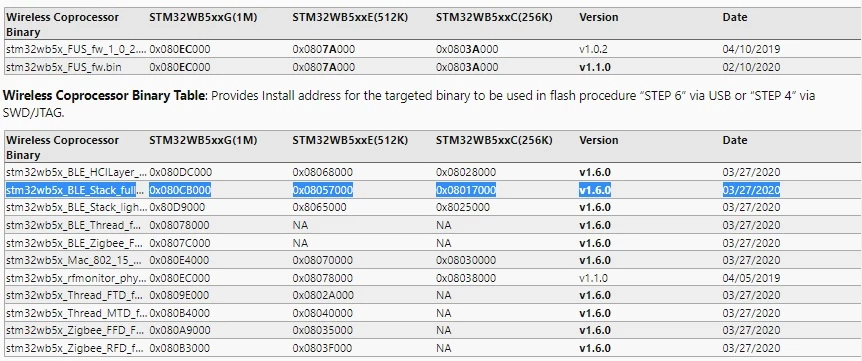

I have STM32WB55REV6 based custom target board which contains 512KB flash. I tried to
download FUS and BLE stack, but it seems like did not programmed correctly and Host controller (CM4) is in wait for event from network processor (CM0). Following batch file command sequence and address used for target STM32WB55REV6 as per release note.
SET BIN=STM32WB5x/stm32wb5x_FUS_fw_1_0_2.bin
SET STACK=STM32WB5x/stm32wb5x_BLE_Stack_full_fw.bin
STM32_Programmer_CLI.exe -c port=SWD -fwdelete
timeout 2 >NUL
STM32_Programmer_CLI.exe -c port=SWD -r32 0x20030030 1
timeout 2 >NUL
STM32_Programmer_CLI.exe -c port=SWD -fwupgrade "%BIN%" 0x0807A000 firstinstall=0 -v
timeout 2 >NUL
STM32_Programmer_CLI.exe -c port=SWD -fwupgrade "%STACK%" 0x08057000 firstinstall=0 -v
pause

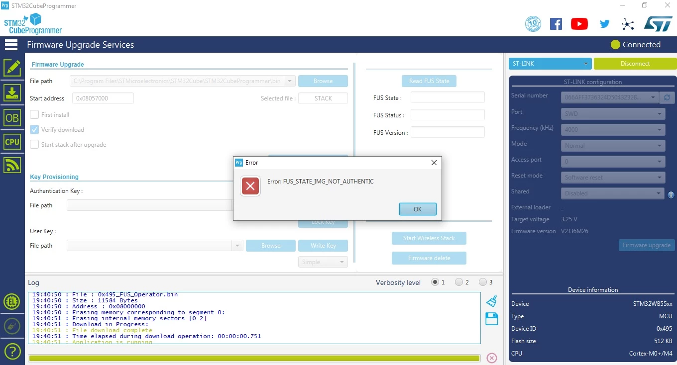

I have tried to run BLE_HeartRate application project from cube firmware version 1.7.0 but what happen the target is disconnect after APPE_Init().
One more think i have do is install latest version of STM32 cube programmer and try to program stack but it shows image authentication error as below.0693W000004H9RkQAK.jpg
I have pick stack and FUS binaries from C:\Program Files\STMicroelectronics\STM32Cube\STM32CubeProgrammer\bin\STM32WB5x (For windows)
Does this be the issue? Does i need authentic stack binaries from ST or something?
Remi QUINTIN
Sep 28, 2020 8:41 AM UTC
FUS binaries have to be those being part of the official CubeWB FW package under
STM32Cube_FW_WB_V1.8.0\Projects\STM32WB_Copro_Wireless_Binaries\STM32WB5x.
You can use the v1.9 version now as it has been officially released last week.
Not that you must not update the FUS again with aversion which is already installed.
Once connected in USB DFU mode, have a look a 0x20030030 to get the FUS version. Based on the result, you will know if you have to upgrade the FUS with a newer version.
