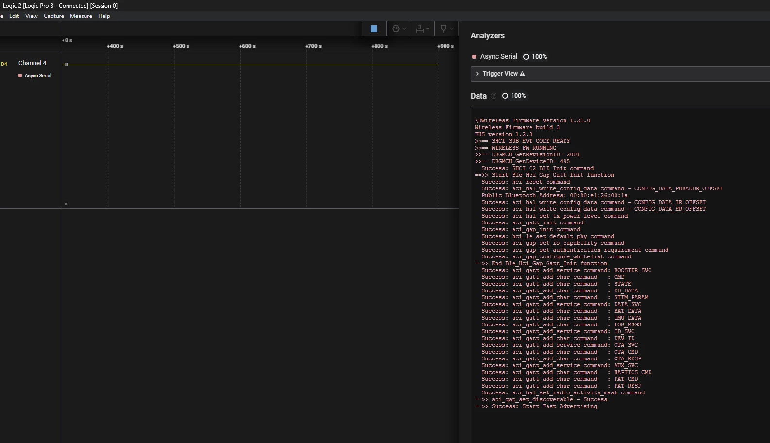

The startup script and linker script is attached as well along with .ioc file used to generate project (wb_1.21.0.zip). This project is using CubeWB v1.21.0. The behavior with CubeWB 1.16.0 is also same on my side. You can check my UART traces from BLE stack as well below:
The main is as follows, attached.

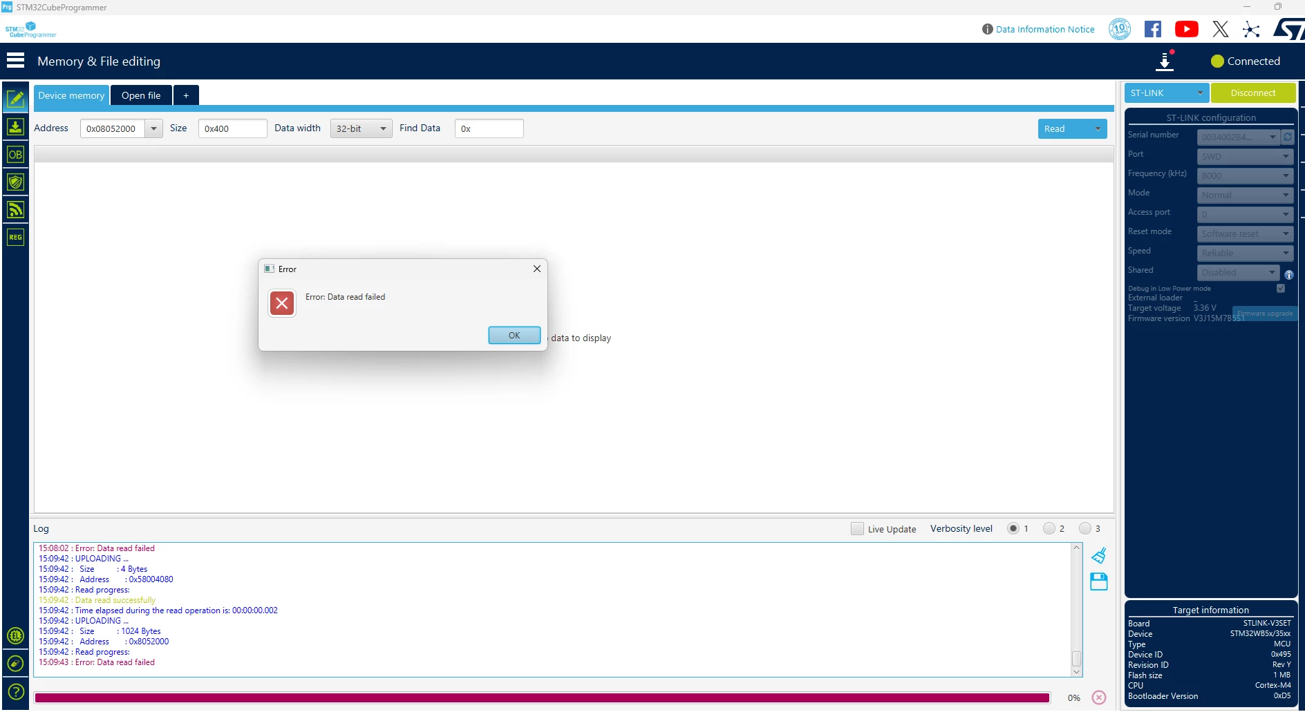

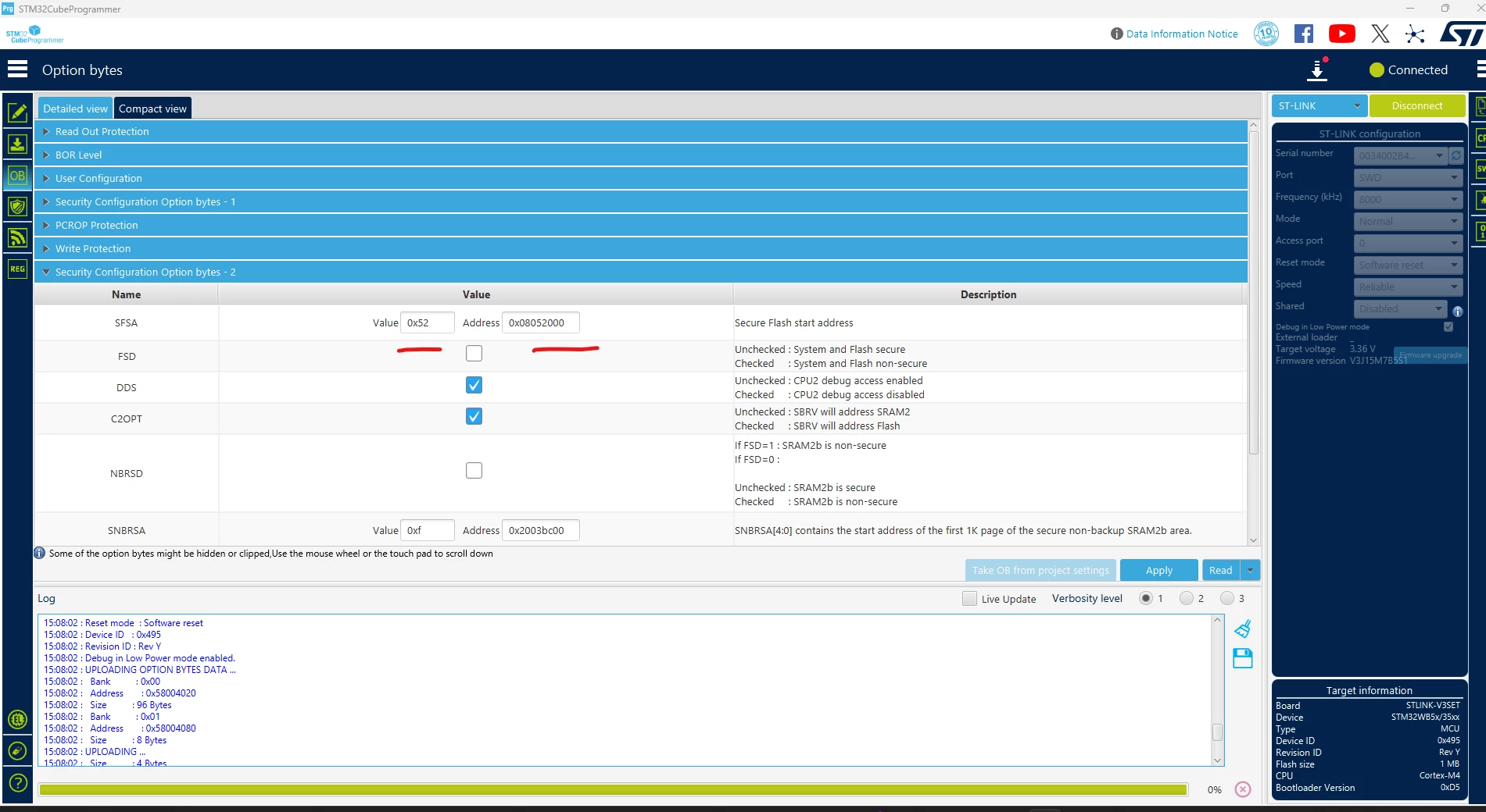

I used SHCI_C2_FUS_FwUpgrade(free_area_address, mem::kBleStackExecAddress);
free_area_address = 0x08052000
mem::kBleStackExecAddress = 0x080D0000
I put BLE stack downloaded via my OTA implementation in free_area_address, now I start FUS and let it know via SHCI_C2_FUS_FwUpgrade to upgrade BLE stack. Our current stack is v1.16.0 and we are going to v1.21.0 hence release notes address taken from v1.21.0 for BLE stack (full).
When I provide any free flash area used as free space or scratch to this API, SFSA changes to that free area address.
This locks this area forever and I using my code or STM32CubeProgrammer cannot read or erase this area ever again.
FilipKremen
FilipKremenBest answer
Apr 22, 2025 11:46 AM UTC
please use the command SHCI_C2_FUS_FwUpgrade() with zero parameters. The parameters are not used.
Regarding the location, FUS can locate it due to image footers. Please read more information in section 6.4.
How to use STMicroelectronics firmware upgrade services for STM32WB MCUs - Application note
Best regards,
ST support
