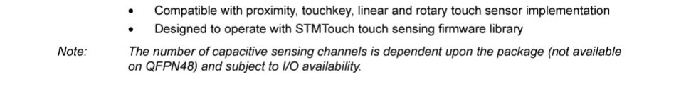

We pointed to STM32WB55CGUX but we see the following note on the datasheet STM32WB55C (page 48):

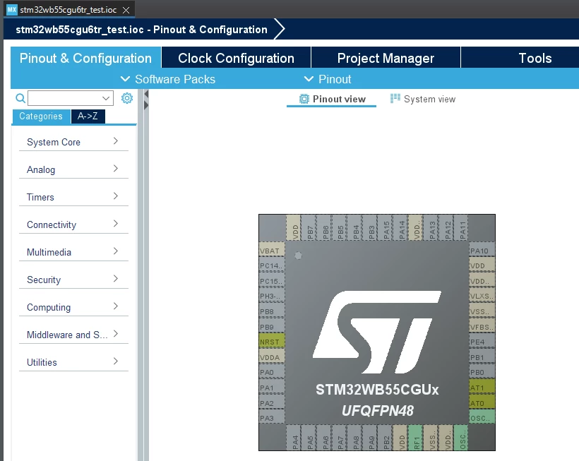

Does that mean that we do not have any available TSC sensing channel on the QFN48 version? Or just that the number of channels is limited? Checking with the Pinout & Configuration tool of the STM32CubeIDE, we do not see any available TSC port at any pin of the STM32WB55CGU6TR (48 pins QFN version).
Instead, we have selected the STM32WBA55CGU6X one, to the detriment of RAM, being 128kB instead of 256kB. If you have any microcontroller suggestion besides this one fitting the main requirements, we would really appreciate it.

Hello @eesy-ES and welcome to the ST Community :smiling_face_with_smiling_eyes:.
The TSC is not supported by the STM32WB55/35 with QFPN48 Package.
For the STM32WBA55, your choice is the most compatible with the needs you have specified on your post (maximum RAM size available for the STM32WBA55 is 128 Kbytes). the STM32WBA55CGU6TR will be the best choice since you can use both NUCLEO-WBA55CG and STM32WBA55G-DK1 for evaluation before Board conception, Mass Market, ...
