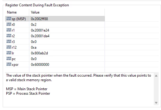

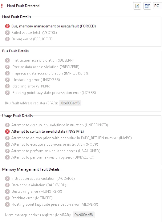

As soon as client makes connection with server, client device go to HardFault_Handler.

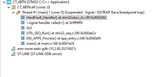

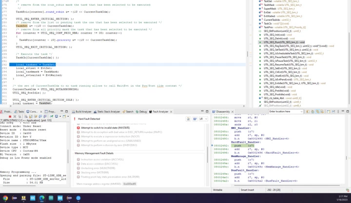

I tried debugging
problem is some where in function UTIL_SEQ_Run
 local_taskset = TaskSet;
 local_evtset = EvtSet;
 local_taskmask = TaskMask;
 local_evtwaited = EvtWaited;
I have not modified anything other than the Button press->start scanning-> find my device -> connect.
I am stuck at this point can some one please help me with this!!!

Remy ISSALYS
Jan 23, 2023 6:07 PM UTC
Did you start from BLE_p2pClient example available in STM32CubeWB package? If it's not the case, where did you register your task?
