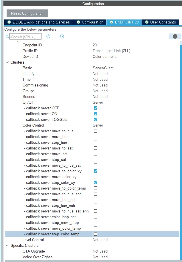

vh789Author
Oct 7, 2024 7:39 PM UTC
Hi Ouadi,
I believe that I have followed all those steps, but just to be sure, here is what I did:
This is my Configuration in CubeMX:
I used this post https://community.st.com/t5/stm32-mcus-wireless/stm32wb55-color-control-cluster-gives-an-assertion-error/td-p/117097 and added
.capabilities = ZCL_COLOR_CAP_XY
To see which commands are coming, I implemented full functionality to the OnOff functions from the examples and to the functions colorControl_server_1_move_to_color_xy and colorControl_server_1_step_color_xy I added a Uart output each, to understand wether the function was called or not.
If it helps, I can also upload my .ioc or even the complete CubeIDE project. Or do you already see something missing here? As I mentioned, the OnOff functionality works flawless.
