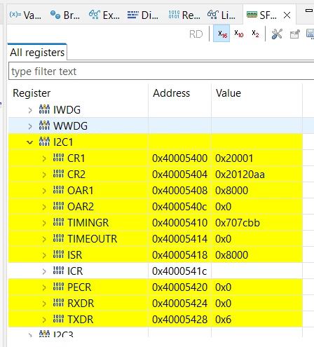

STM32WB55CG I2C MASTER COMMUNICATION FAILURE
I'm trying to read battery information from a BMS chip (I2C slave) via I2C.  And I also tried to capture the clock signal on SCL with scope but it failed.  This chip is already used in our other project with another MCU.  This is my first time to use STM32WB55CG. Could you help me with the issue, please?
Here's my screenshot of I2C register.
Here's my source code for I2C.

STTwo-32
Sep 26, 2024 3:59 PM UTC
Hello @DFeng.2
For the Implementation of the I2C on the STM32WB55CG, you may want to take a look at the examples Here. They should be really helpful.
Best Regards.
