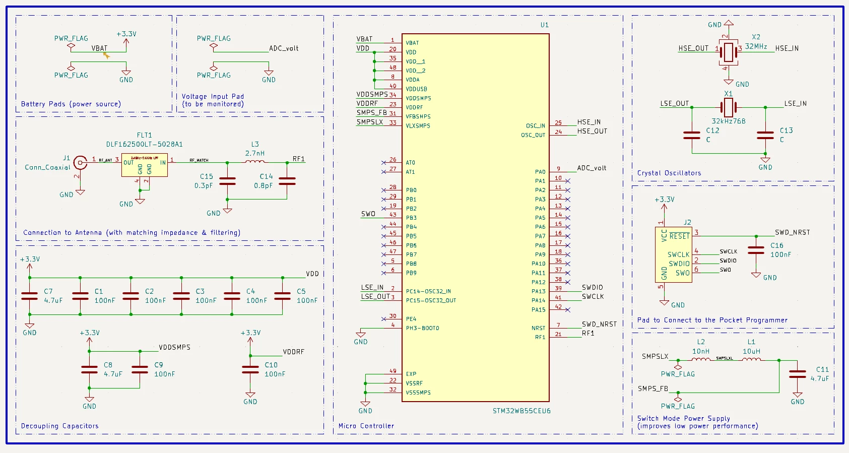

STM32WB55CEU6 with External Battery
Hello ST Community,
I am working on a circuit using the STM32WB55CEU6 micro controller and bluetooth to transmit information from one of the ADC Pins. I followed some references that have the circuit powered by a USB C connection, however in my situation it will be powered by an external battery (imagining that it is 3.3V - I could add a voltage regulator later on).
As I am not at all familiar with microcontrollers and this whole process in general, I was wondering if I could have someone check my circuit shown below. I have boxed out in the top left corner where the pads will be to solder in wires connecting to an external battery. I connected the battery's positive terminal (labeled the wire VBAT) to the VBAT pin, additionally, I've connected an outgoing +3.3V to the decoupling capacitors and the pocket programmer sections. So the ERC (electrical rules check) in KiCad V7 is giving me the warning “Both VBAT and +3.3V are attached to the same items”. I am wondering if this is the correct way to connect a battery. Any assistance on this would be greatly appreciated.

Hello @RisingElectricalEngineer,
First of all I can recommend you to take a look at this wiki article https://wiki.st.com/stm32mcu/wiki/Basics_of_power_supply_design_for_MCU which may help you on the design of power supply for STM32.
About VBAT, this is a power supply pin for the backup power domain, this is not to supply the whole application with a battery. In your case, if you only have one power supply, VBAT should be linked to VDD.
Then, please consider that:
  • The voltage of the battery varies depending on the charge and the current load, so a voltage regulator is recommended.
  • The battery can be damaged if over discharge, so consider add a battery management/monitoring system if not already the case.
In conclusion your schematic only misses a voltage regulator and a security feature for the battery.
