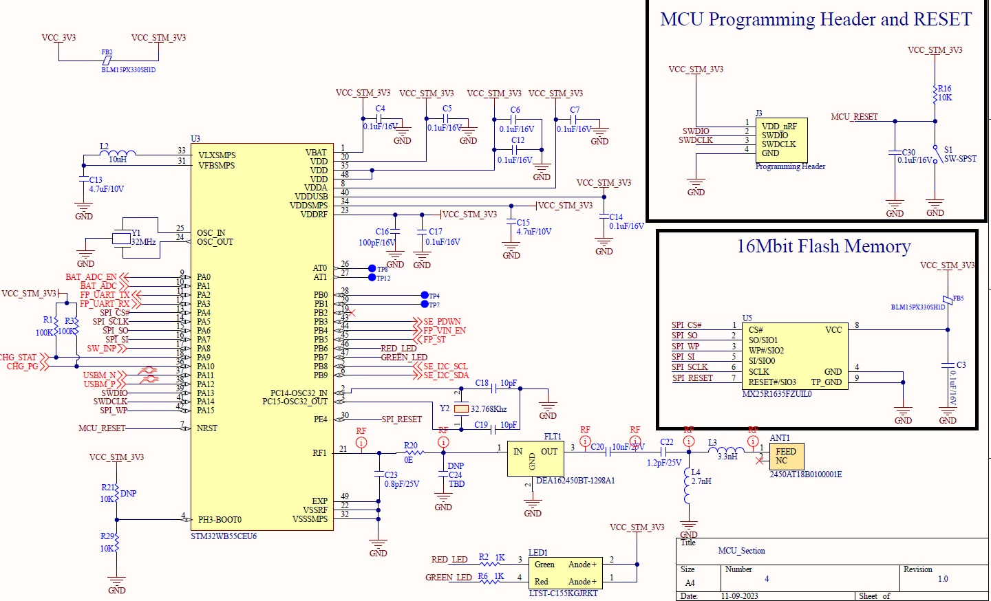

We are using STM32WB55CEU6 in one of our project and we are facing the issue in BLE. We checked all the powers and soldering related things, everything looks fine. But BLE is not able to advertise.
Also, from the firmware side the same code is working in Nucleo board.
We used 2450AT18B0100001E Antenna and DEA162450BT-1298A1 Filter.
Let me know if the Circuit has any issue.
Below I am attaching the Schematic File for MCU section.
Thank You.

I suggest you to refer to the AN5165  to understand more about the RF HW design using the STM32WB (the figure 8 should be a good start to the design).

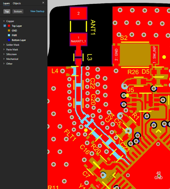

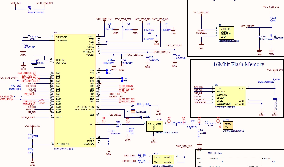

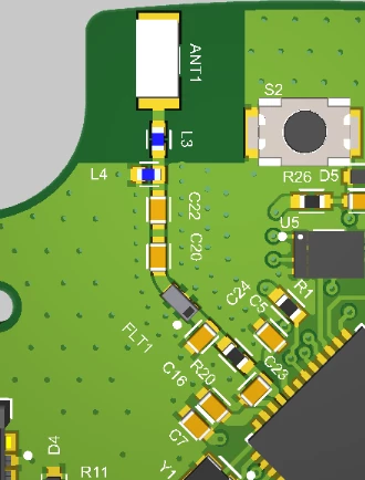

We have done the same schematic design as per the recommendation in AN5165 and NUCLEO-WB55. I am attaching our board's Schematic and Layout part for STM32 RF design.
RF trace path is on Top layer (50 ohm impedance control) and we took 3rd Layer as a reference layer.
As mentioned earlier we used 2450AT18B0100001E Antenna and DEA162450BT-1298A1 Filter.
Please review it and let me know if any changes is required in our design from Hardware side, as we are not getting any BLE advertisement.
If Hardware looks good then we need to start looking from Firmware side.
Waiting for your response.

NishanttAuthor
Jan 4, 2024 6:36 AM UTC
Hello @STTwo-32,
Did you check the Schematic and Layout?
Please let me know if there any issues in Schematic or Layout.
