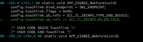

Hello
 I need to develop low power wireless device which is suitable of making target devices to join a network. After doing research I came to a conclusion Zigbee Touchlink(TL) Initiator Sleepy End Device(SED). But STM32CubeWB does not have any Touchlink examples so currently testing with existing coordinator and router examples with their .ioc configuration changed to Touchlink. I see no problem making connection between "RFD-TL-Initiator-ED" and "FFD-TL-Target-Router" but when ED is changed to SED the connection fails.
 Only code difference between SED and ED is that SED does not set ZCL_TL_ZBINFO_RX_ON_IDLE flag on function APP_ZIGBEE_NwkForm().
So my question is
1. Is there another way to make SED-Initiator combination work? (maybe some example codes)
2. Is SED-Initiator combo not workable by Zigbee itself at the first place?
3. Maybe there's something else I am missing on?

Code difference between ED and SED is the greeb line in below image does not exist in SED code generation.

Hello @tommy15433,
Thanks for contacting ST Support and welcome to the community.
Regarding your case, it seems that the initiator configured as a Sleepy end device goes to sleep mode in the commissioning phase and leads to losing some response packet from the target.
A ticket has been created internally to look at this specific case, we will reach you asap with the last status.
For now, I recommend to use the initiator configured as ED with no sleep mode enabled.
