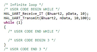

Hi
I`m using PNUCLEOWB55 Board for testing USART1 interrupt communications.
I have started a project from scratch using CubeID 1.10.1 and choosed PA9 and PA10 as TX/RX respectively with following configuration 115200Baud, WordLen 8bits(including parity), Stop bits None , Parity None.TeraTerm on the PC is also configured same way.
I have enabled NVIC interrupts and using receive callbacks like below
/* USER CODE BEGIN 4 */
void HAL_UART_RxCpltCallback(UART_HandleTypeDef *huart)
 HAL_UART_Receive_IT(&huart1, &data[0], 10);
/* USER CODE END 4 */

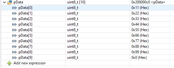

Callback is executed after 10 characters have been send from TeraTerm. Problem is , data array holds entirely different data from what I have sent. I have also tested
USART_Communication_Rx_IT example project but still similar issue.
I have also tested PB6 and PB7 but nothing changed. There is nothing wroing with the generation of interrupt or execution of callback. On the PC side I`m using a USB to serial converter cable. This is how USART1 is initialised

All of the code I have pasted here is generated except the calls to HAL_UART_Receive_IT  and HAL_UART_RxCpltCallback.
I started to think that there is another problem with the board itself .
I started to think there is something wrong with my board jumper settings or clock tree configuration but can`t tell where to look at.
Can you tell me what i might be missing ?
Thank

I don't see anything wrong in the code.
Do you loop back test. Connect the Tx and Rx pins together on your board. Create an array below your data array you've declared
Place a break point in the HAL_UART_RxCpltCallback and just before main while loop transmit the data. It should break. See if the contents of your data array has the transmitted data. If it matches then it has to be some other issue like Tera term not set for the correct baud rate. Or maybe the USB to UART interface has issues?
I can have the STM32 device set for 115200 and a serial program set for 57600 and still interrupt with 10 bytes. The received data ended up being garbage.
You don't have to declare your variable static if you place your first HAL_UART_Receive_IT before main while loop
The debugger will break and you should see the tx contents nData in your data (pData for me)0693W00000WIpNZQA1.png
If a reply has proven helpful, click on Accept as Solution so that it'll show at top of the post.CAN Jammer an open source CAN bus hacking toolCANableV3 Open Source
