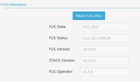

FUS seems to be in bad state :

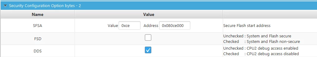

By comparaison with a working board, I find that a secure flash address has been configured to this MCU and it overlap the FUS/radio firmware address :
Now I'm trying to revert back this value to the factory 0xF4 value but I'm unable to do so.

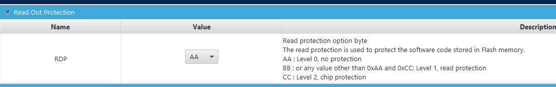

1) Connect using STM32CubeProgrammer, make sure no RDP or write protection are activated in option bytes

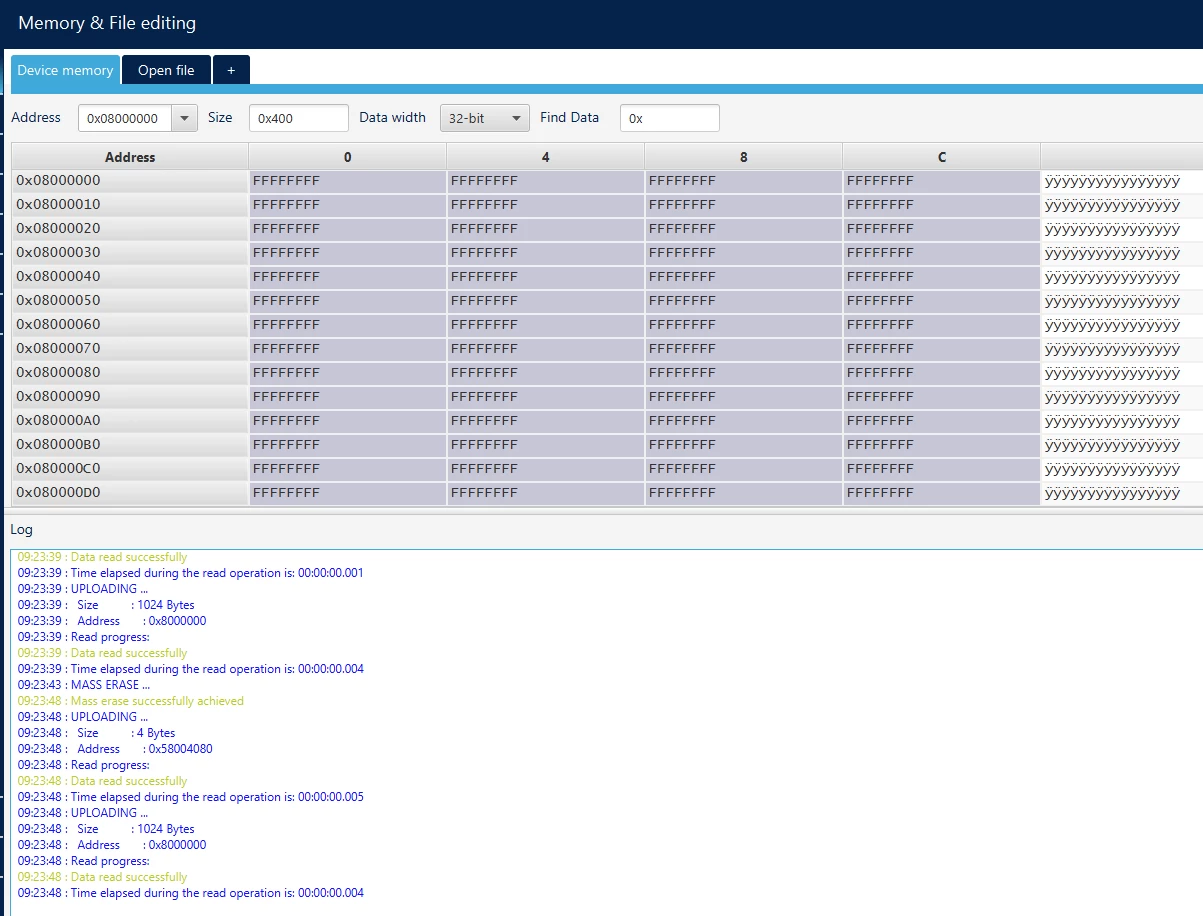

2) Perform mass erase (to be sure about FW running in the MCU and be sure FUS operator is detecting right FW in memory)

1) No RDP :

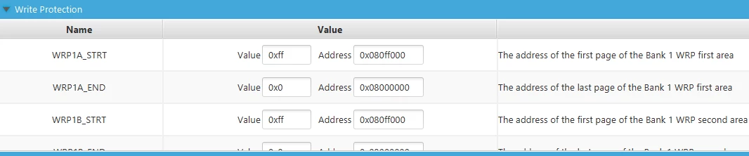

No write protection (I think) :
2) Perform a mass erase :

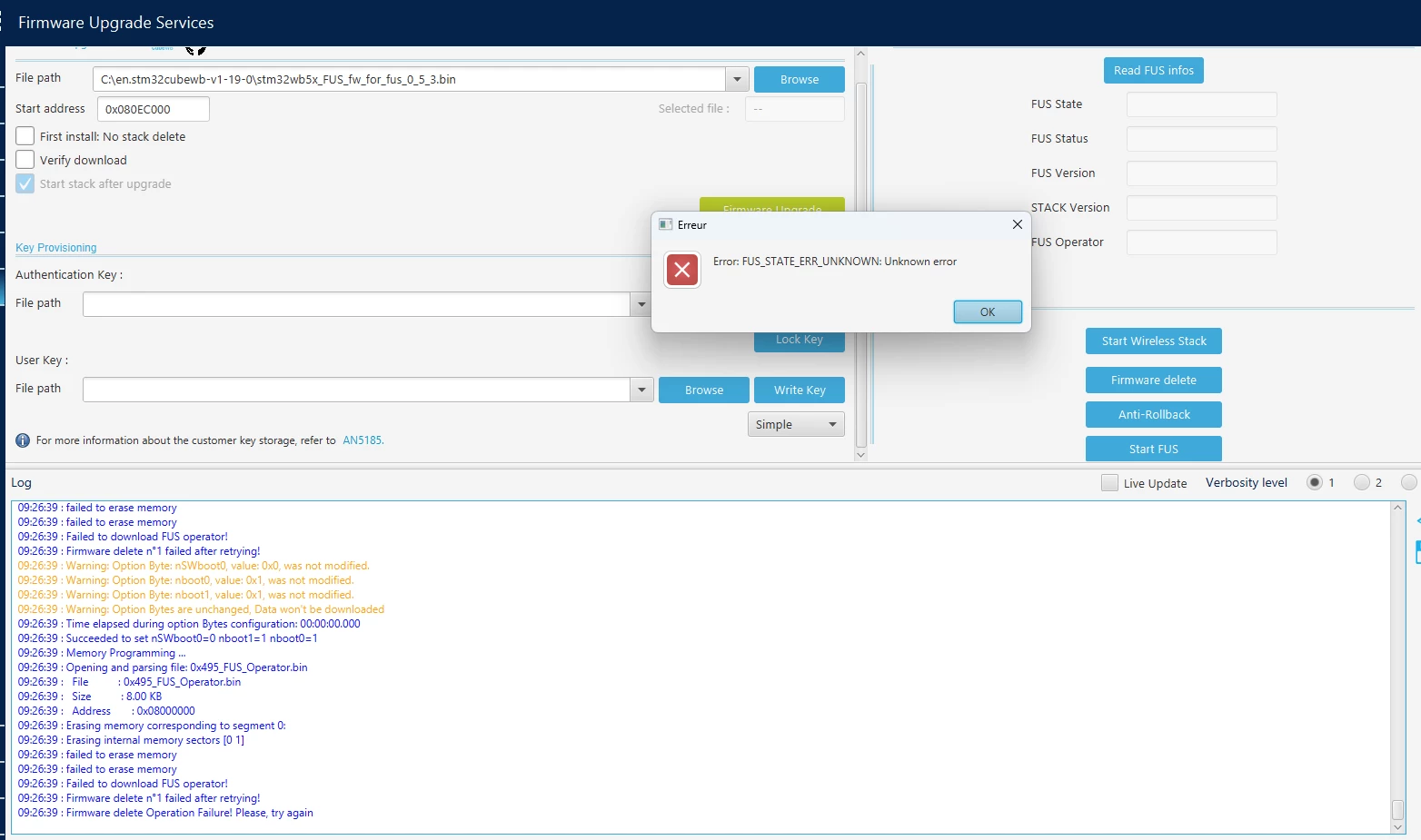

3) Trying to delete radio firmware :
And got an error...

thank you for posting pictures showing your steps. The last one with error shows also the log. From the log I can see operations fails, when STM32CubeProgrammer is erasing first two sectors (8 kB starting 0x08000000) to load FUS operator, but erase of those 2 sectors fails. Also before that is in log "failed to erase memory", but not visible to which commands it's tight.
This is typically issue with write protection, which you show is not enabled. Could you please verify write protection is not active?
Please check PCROP as well.

When not successful, please post post also picture with Security Configuration Option bytes - 2.
