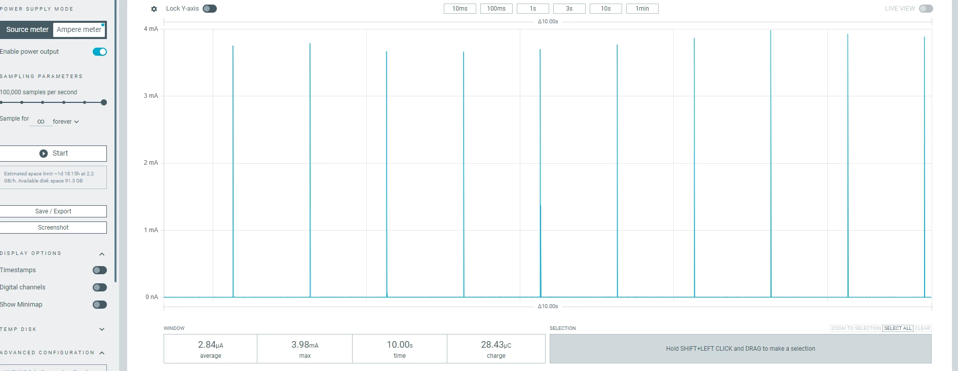

I'm developing a battery-powered application for the STM32WB55 (specifically the STM32WB55RGV6) and am seeing periodic pulses or spikes in the SoC's current consumption every 200ms in STOP2 and standby modes. These pulses occur with the Nucleo board MB1355-C02 as well, though the pulses have a different shape on the Nucleo board than the ones I can observe on the board I designed. I have tried the demo firmware in addition to my own, and observe the pulses with it as well.

Is that on a part with SMPS? Probably when sleeping, SMPS is in pulse skipping mode. When VFBSMPS has dropped some margin, C2 from Figure 4 "Pwer distribution " is recharged. Higher temperature -> Higher leakage -> more frequent recharge

Thanks for your reply, and a very interesting theory! The part does have a SMPS, but in the STOP2 and standby modes, the SMPS is open and the LDO is powering the low-voltage core. I checked the switching node for the SMPS (called V_LXSMPS on this part) with my scope and saw no switching there.

I seem to be having the same issue on the STM32 NUCLEO WL55JC1 board. I'm running code adapted from a firmware example that defaults to the STOP2 mode when there are no tasks, but there are periodic spikes that I can't understand. For more context, my ammeter is the nordic PPK 2 and I have my probe on the JP1 I_SOC jumper; the example i adapted from is the STM32WL Ping Pong example with LoRa modulation. Please help. Thank you.
