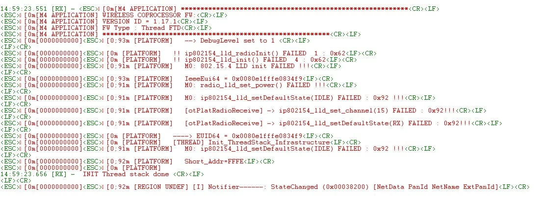

Dear support team,
I was trying to build a thread device with a nucleo-wb55rg board. I did the following steps:
- Implement Full chip erase
- Upgrade firmware STM32Cube_FW_WB_V1.17.3\Projects\STM32WB_Copro_Wireless_Binaries\STM32WB5x\stm32wb5x_Thread_FTD_fw.bin at address 0x08083000. I referred to the release note, the firmware version is V1.17.1
- Download example Thread_Cli_Cmd and build/upload
- I got it running but it says the radio failed and many issues exist. Please have a look at the attached image.
Please help me check it. What should I do?

Hello @LongHoang and welcome to the ST Community.
I suggest you use the Thread_RCP_Cli_Cmd as recommended on this WIKI. Also, I suggest you use the last version of the firmware STM32Cube_FW_WB_V1.18.0.
Best Regards.
