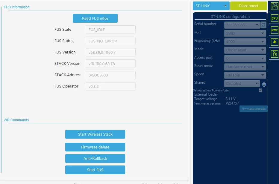

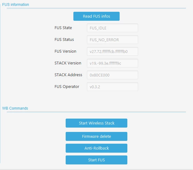

1. Corrupted Device Information (SWD_READ_FUS.PNG)
When reading FUS info via ST-LINK (SWD), the device returns corrupted version numbers:
  • FUS Version: v68.39.fffffe0.7
  • STACK Version: vfffffff0.0.68.78

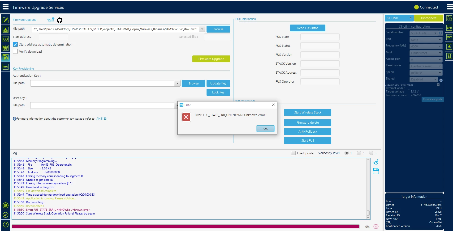

2. FUS & Wireless Stack Operation Failures (SWD-START-FUS.PNG / SWD-START-WIRELESS.PNG)
Attempting to start the FUS or Wireless Stack results in:
  • Error: FUS_STATE_ERR_UNKNOWN: Unknown error
  • Log: Start FUS Operation Failure! and Start Wireless Stack Operation Failure!

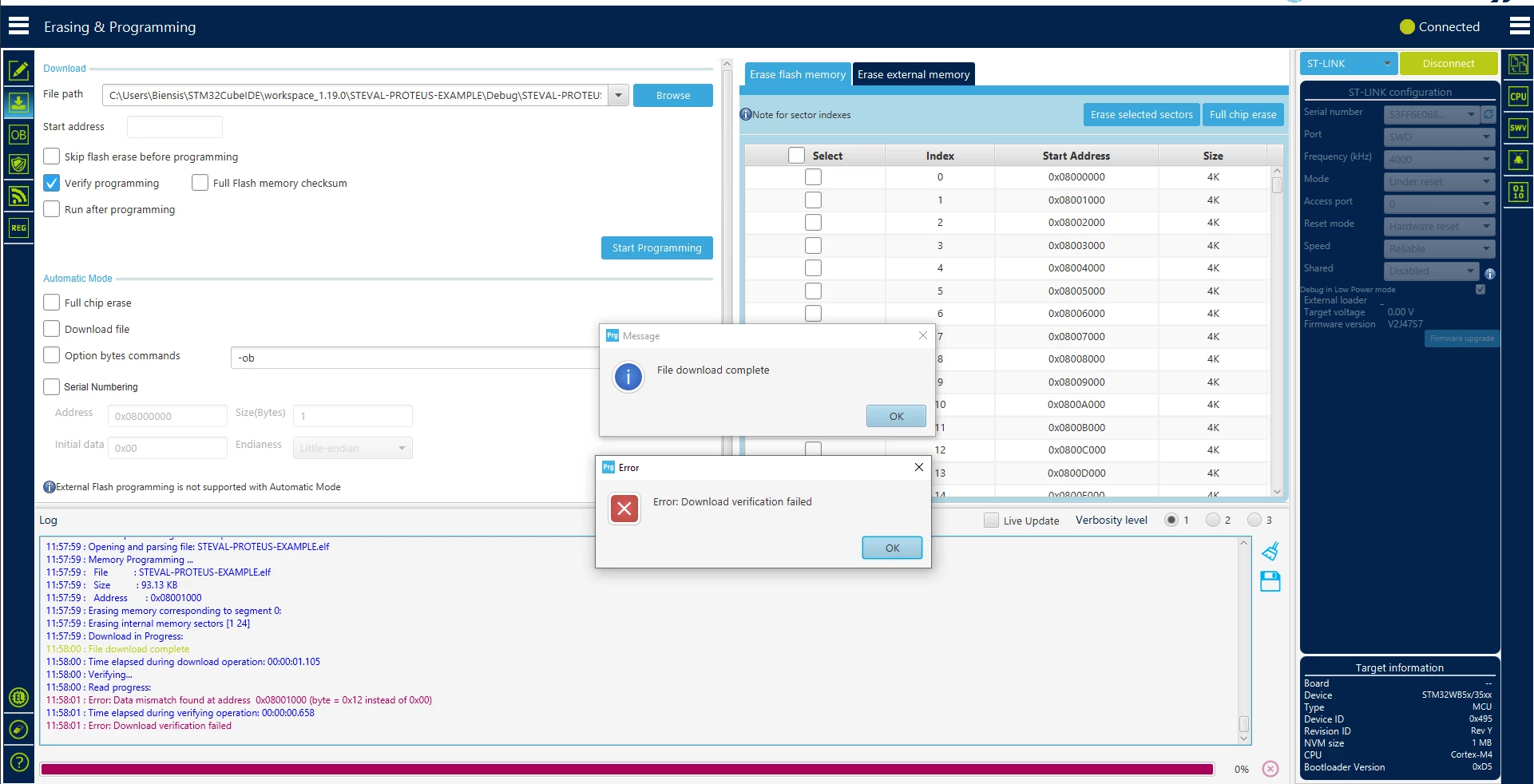

3. Flash Write & Verification Mismatch (SWD-UPLOAD-CODE.PNG)
I am unable to flash a standard application elf file. Even though the device is connected via SWD:
  • Error: Data mismatch found at address 0x08001000 (byte = 0x12 instead of 0x00)

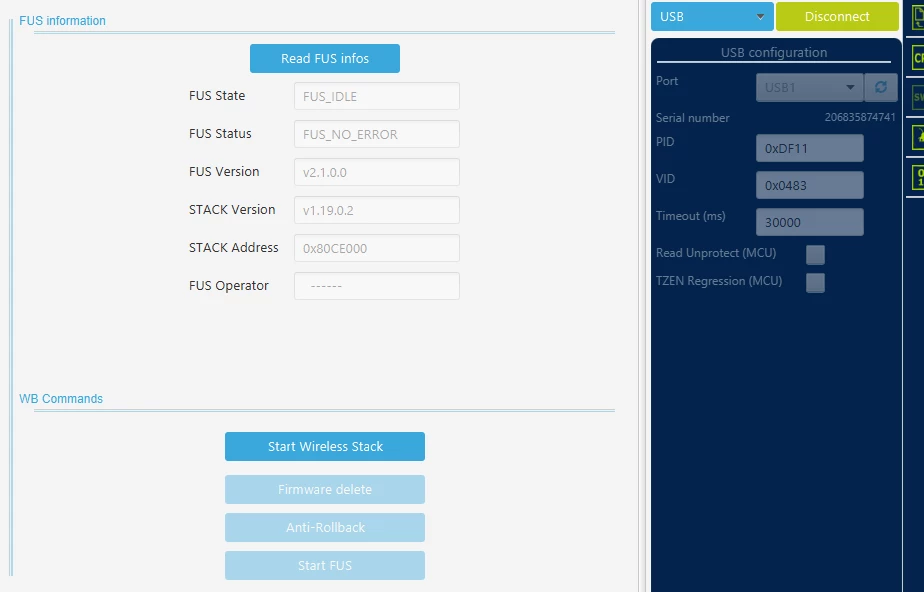

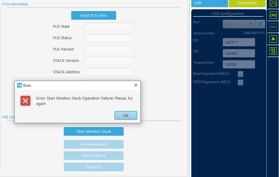

4. USB DFU Mode Inconsistencies (USB-READ-FUS / USB-START-WIRELESS)
Switching to USB (PID: 0xDF11) shows inconsistent states:

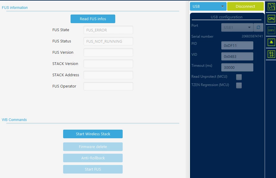

  • In some cases, FUS reports FUS_STATE_ERR and FUS_NOT_RUNNING (USB-READ-FUS2.PNG).

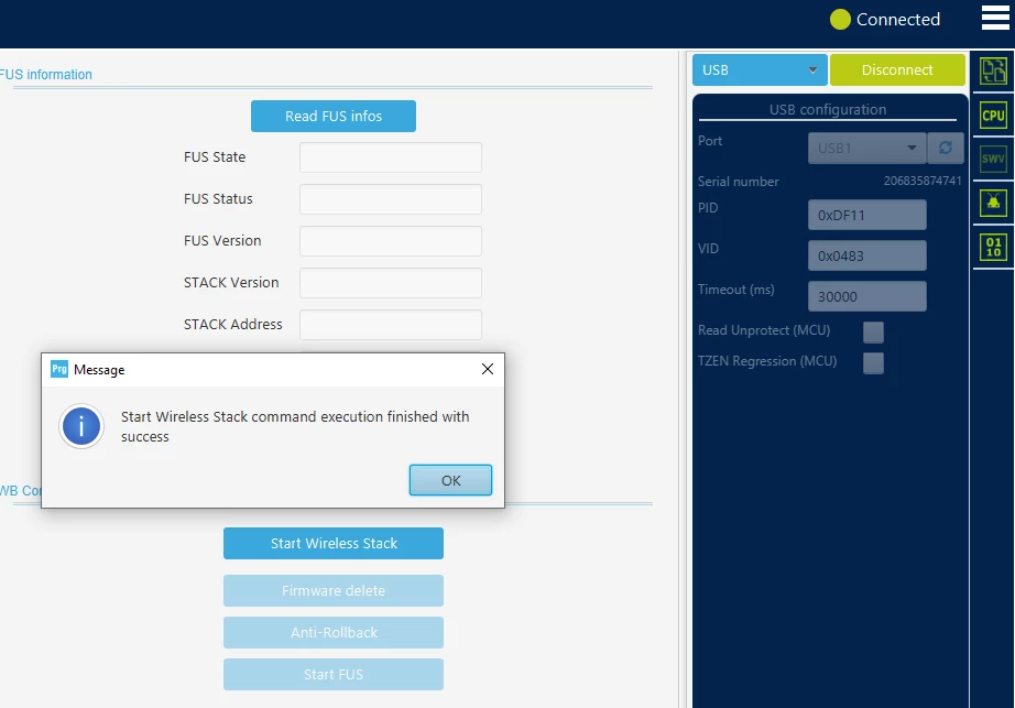

  • Even when a command reports "Success" in the log (USB-START-WIRELESS2.PNG), the operation has no actual effect on the device state.
  • Critical Error: Any attempt to download code via USB fails with Error: failed to download Sector[0] (USB-UPLOAD-CODE.PNG).

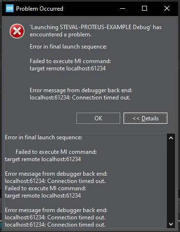

5. IDE & Debugger Accessibility (STM32CUBEIDE.PNG)
Because of this deadlock, STM32CubeIDE cannot establish a connection:
  • Error: Connection timed out (localhost:61234). The GDB server is unable to halt or communicate with the core.

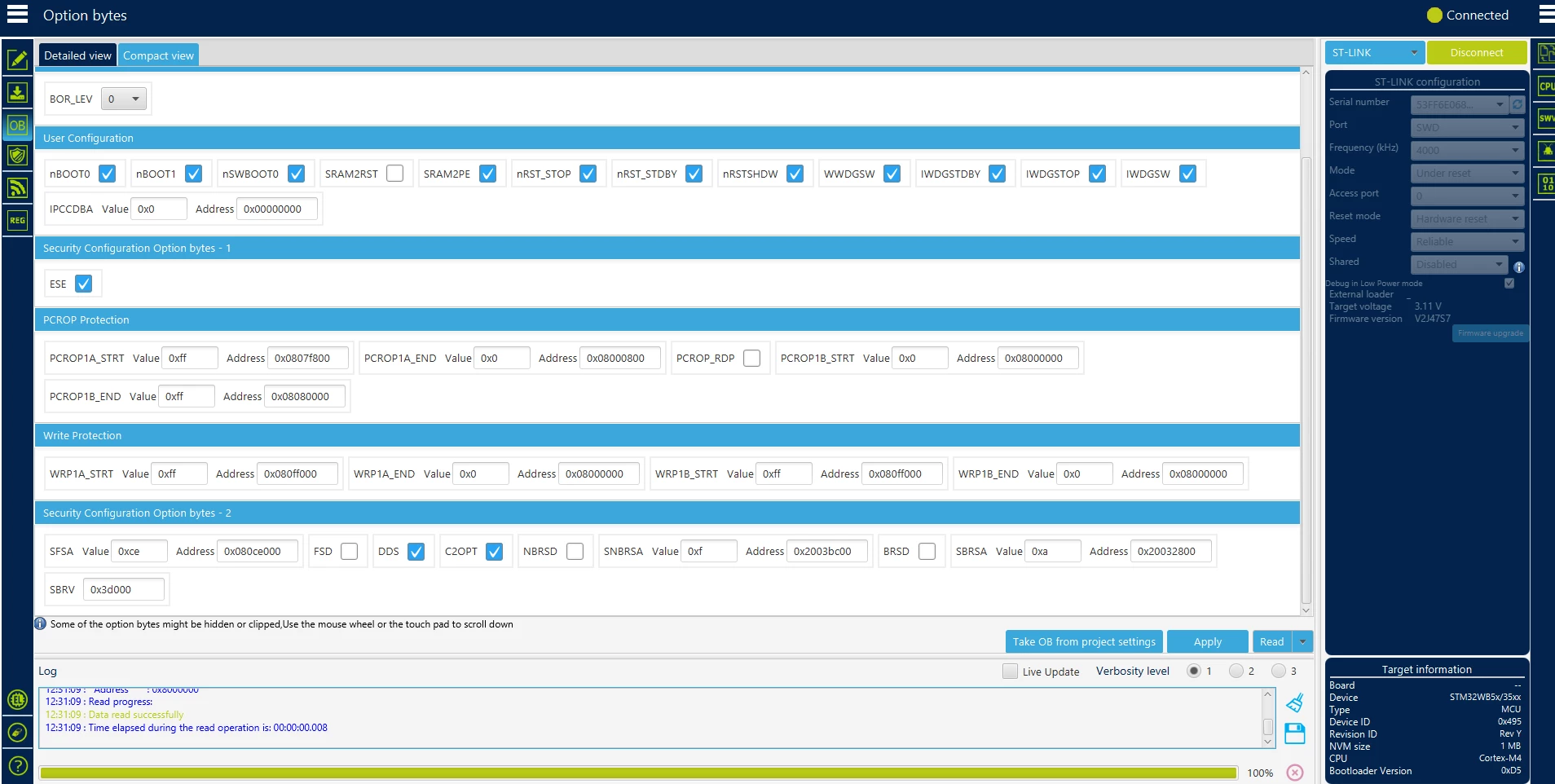

I have also attached my current Option Bytes configuration to see if there is a conflict in boot settings or memory protection that causes this deadlock. Any advice on the correct OB values for FUS recovery would be greatly appreciated.
Note: RDP is AA.

Hello @Imen.D
Thank you for response.

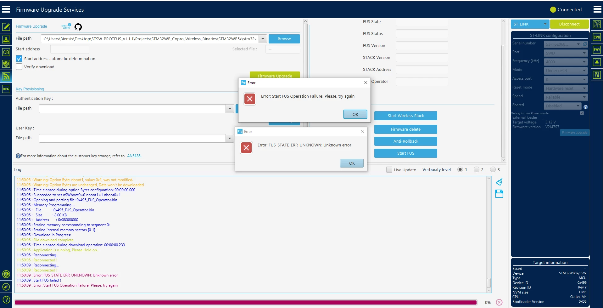

When I click "Read FUS infos", I see the following as shown in the image:
FUS Version: v27.72.fffffcb.fffffffb0 (FUS Operator: v0.3.2)
STACK Version: v19.-99.3e.ffffff9c
However, when I try to "Start FUS", I get the FUS_STATE_ERR_UNKNOWN error in the logs. The same thing happens when I try to "Firmware delete".
Logs for Start FUS:
10:54:20 : Succeeded to set nSWboot0=0 nboot1=1 nboot0=1
10:54:20 : Opening and parsing file: 0x495_FUS_Operator.bin
10:54:20 : Memory Programming ...
10:54:20 : File : 0x495_FUS_Operator.bin
10:54:20 : Size : 8.00 KB
10:54:20 : Address : 0x08000000
10:54:20 : Erasing memory corresponding to segment 0:
10:54:20 : Erasing internal memory sectors [0 1]
10:54:20 : Download in Progress:
10:54:20 : File download complete
10:54:20 : Time elapsed during download operation: 00:00:00.238
10:54:20 : Application is running, Please Hold on...
10:54:20 : Reconnecting...
10:54:20 : Reconnected !
10:54:24 : Reconnecting...
10:54:24 : Reconnected !
10:54:24 : Error: FUS_STATE_ERR_UNKNOWN: Unknown error
10:54:24 : Start FUS failed !
10:54:24 : Error: Start FUS Operation Failure! Please, try again

Mar 24, 2026 3:55 PM UTC
Did you check the value of the SFSA and SBRV option bytes?
ZakhanAuthor
Mar 25, 2026 8:24 AM UTC
SFSA = 0xCE,  Address = 0x080CE000
SBRV = 0x33800
