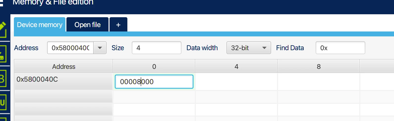

Ok, Ive been searching all over for this answer and I just found it. Here: https://wiki.stmicroelectronics.cn/stm32mcu/wiki/Connectivity:STM32WB_FUS
Accidentally, I got SFSA = 0x00 and SBRV= 0x3FC00 what's happened?
This is due to option byte corruption, or to supply voltage or level stability. This configuration of the SFSA/SBRV option bytes means that the STM32WB hardware forces the boot to Safeboot whatever the firmware being run. To activate Safeboot and perform a factory reset the user must activate the Cortex-M0+ by writing the value 0x00008000 to address 0x5800040C using the SWD interface.
If a FUS version lower than V1.1.0 is running, then no recovery is possible at this point.
Hopefully you have an up-to-date FUS, otherwise its a brick for good.
This is what I did in STM32CubeProgrammer - Fill in the address, set the 8 and hit enter.
