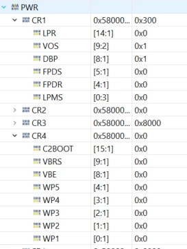

  • When you are stuck in the while, can you share the value of PWR_CR1, PWR_CR4, RCC_BDCR (especially LSEON, LSEBYP bits) ?

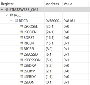

- Following are the values of the registers:

  • I saw on your screen that LSECSSD is equal to 0x1. It means a failure is detected on LSE (32 kHz oscillator) by the CSS. Have you try with the LSI clock ?

  • Unfortunately, I just checked ES0394 and the issue is mentionned (it's n° 2.2.2 : Unstable LSI1 when it clocks RTC or CSS on LSE) You need to apply one of the following measures :
    • Clock the RTC with LSE or HSE/32, without using the CSS on LSE.
    • If LSI1 clocks the RTC or when the LSECSSON bit is set, reset the backup domain upon each VDD power
      up (when the BORRSTF flag is set). If VBAT is separate from VDD, also restore the RTC configuration,
      backup registers and anti-tampering configuration.
  • Also, are you using PC13 in your application ? (I am referring to issue 2.2.6 : PC13 signal transitions disturb LSE)
  • Can you confirm this is the problem (VBAT is separate from VDD and VDD goes off then on) ? And can you please try the workaround and let me know ?
