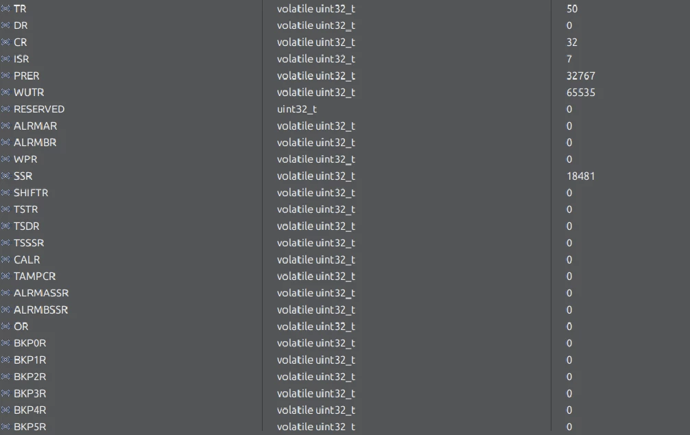

APort
APortAuthor
Aug 16, 2022 1:03 PM UTC
Well, with minimal configuration, just a tight loop after minimal init, it happens even faster.
Below is the block registers when it happens (all look pretty normal to me).
I would understand issue with the clock or faulty read value, but this thing is very consistent, and I can't imagine oscillator issue causing it (we did check just to be sure, it looks alright).
I have a feeling it has something to do with reading it in a tight loop, but with no shadow registers enabled, it should not be a problem.
