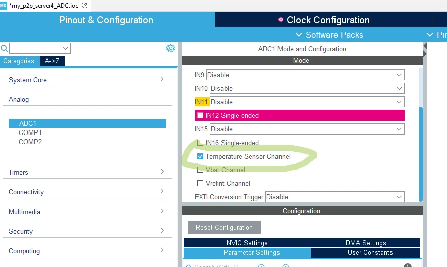

STM32WB55 program was stuck if both BLE and ADC is activated
I have an STM32WB55 board. I used the CUBEMX to generate a template that both activates the internal temperature sensor and BLE module.
However, if I ran the program generated, it will be blocked in the "hw_timeserver.c" at line 566, which is:
while(__HAL_RTC_WAKEUPTIMER_GET_FLAG(phrtc, RTC_FLAG_WUTWF) == RESET)
If I turn the ADC off, the program will start properly, and I am able to scan and connect. the problem seems relative to the clock configuration, but I have no idea how to debug it.
I attached my CUBEMX setting file. Can anyone helps me find the problem?

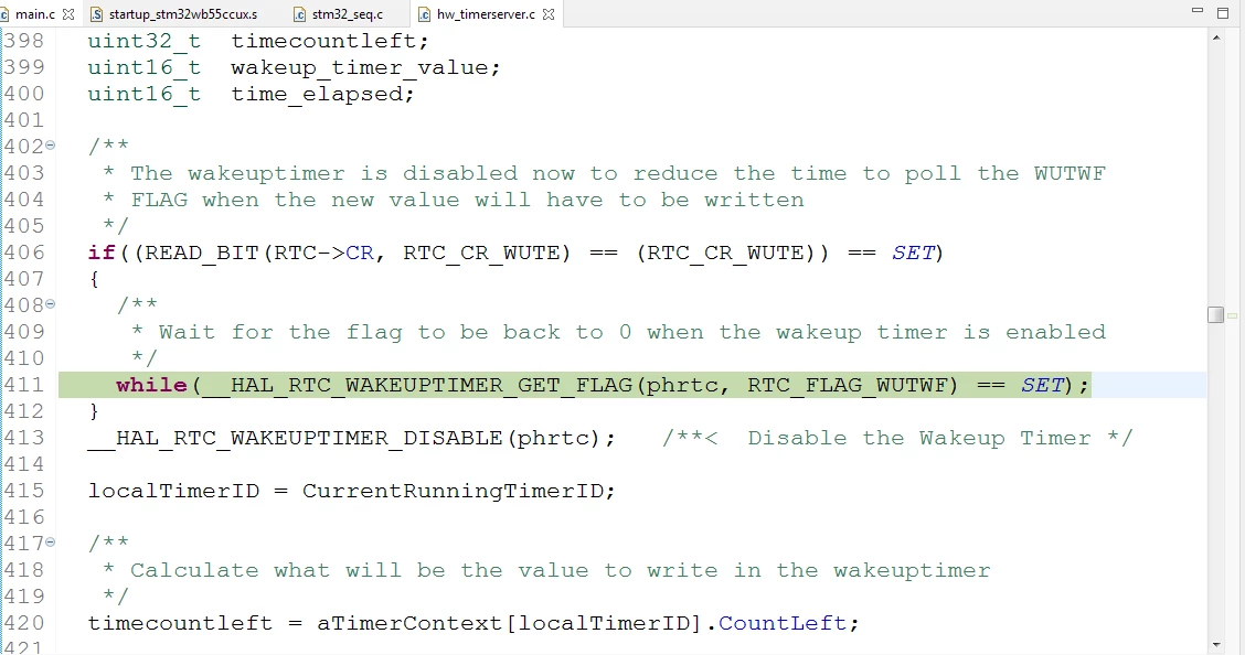

I also add ADC on temperature channel in project my_p2p_server4_ADC. Sometimes client doesn't see server. I pause debagger and see
"hw_timeserver.c" at line 411 (not 566 like @ZZou.1​ :(
    * Wait for the flag to be back to 0 when the wakeup timer is enabled
   while(__HAL_RTC_WAKEUPTIMER_GET_FLAG(phrtc, RTC_FLAG_WUTWF) == SET);
