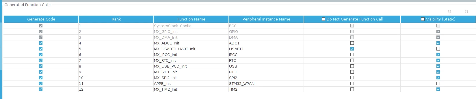

Struggling with an issue with the WB55. I'm attempting to see BLE stack debugging through the UART. I've tested the redirect without WPAN being enabled and found the hardware is functional. When I enable WPAN debugging, redirect function is never called.
main.c
int __io_putchar(int ch);
	/* e.g. write a character to the USART1 and Loop until the end of transmission */
	HAL_UART_Transmit(&huart1, (uint8_t *)&ch, 1, 0xFFFF);
	return ch;
 Setting up the debugging for WPAN has been done to setup guide:
MX_USART1_UART_Init() isn't called in the main() function but called in the DbgOutputInit() function:
/* USER CODE BEGIN APPE_Init_1 */
#ifdef DEBUG
 DbgOutputInit();
#endif
/* USER CODE END APPE_Init_1 */
I've verified the initialization code is being called:

Getting a little closer, the WPAN library overrides the standard lib function for redirect:
#if (( CFG_DEBUG_TRACE_FULL != 0 ) || ( CFG_DEBUG_TRACE_LIGHT != 0 ))
#if defined(__GNUC__) /* SW4STM32 (GCC) */
 * @brief	_write: override the __write standard lib function to redirect printf to USART.
 * @PAram	handle output handle (STDIO, STDERR...)
 * @PAram	buf buffer to write
 * @PAram	bufsize buffer size
 * @PAram	...: arguments to be formatted in format string
 * @retval none
size_t _write(int handle, const unsigned char * buf, size_t bufSize)
 return ( DbgTraceWrite(handle, buf, bufSize) );
Found in dbg_trace.c. It is called, but it appears that the buffer used for the CircularQueue is returning a null address:

Success! Queue and hw_huart needs to be initialized. This can be done by calling:
 APPD_Init();
app_entry.c
void MX_APPE_Init(void)
 System_Init(); /**< System initialization */
 SystemPower_Config(); /**< Configure the system Power Mode */
 HW_TS_Init(hw_ts_InitMode_Full, &hrtc); /**< Initialize the TimerServer */
 APPD_Init();
