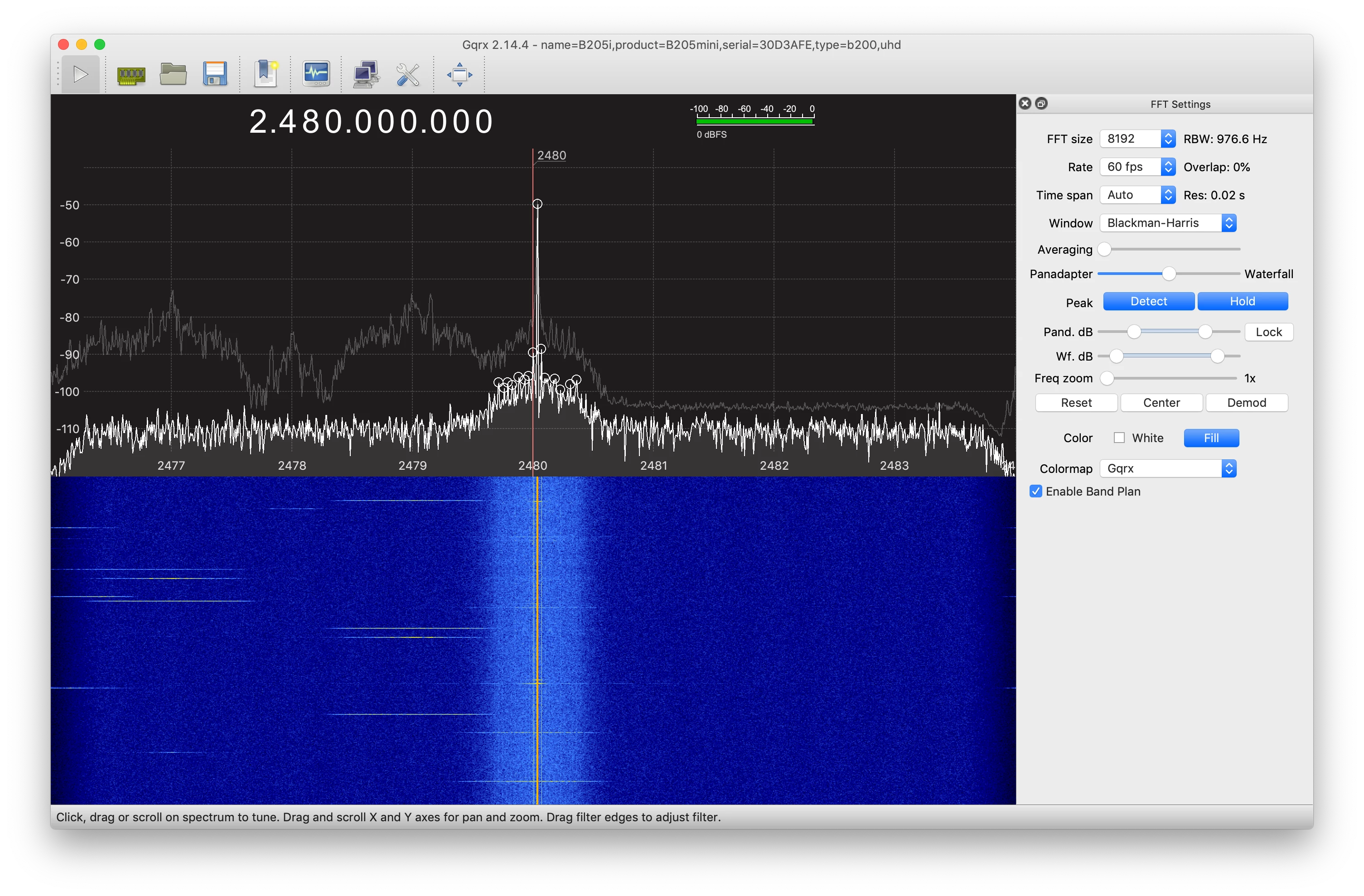

Remi QUINTIN
Sep 24, 2021 8:28 PM UTC
Can you capture a picture of the spectrum around the channel frequency used for the communication?
The question behind is whether the DC-DC converter is impacting the power or the RF area via spurious harmonics.
Aku

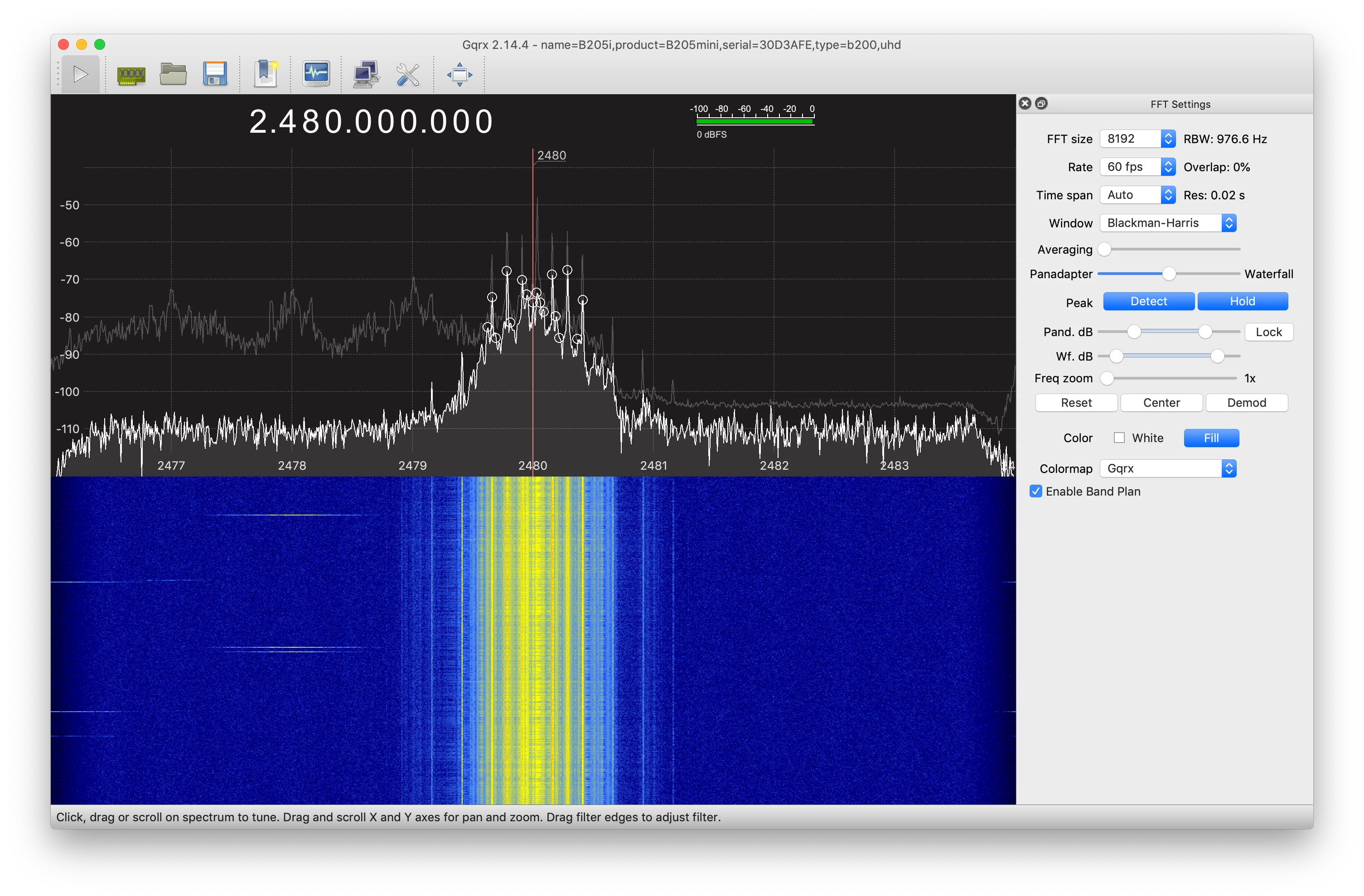

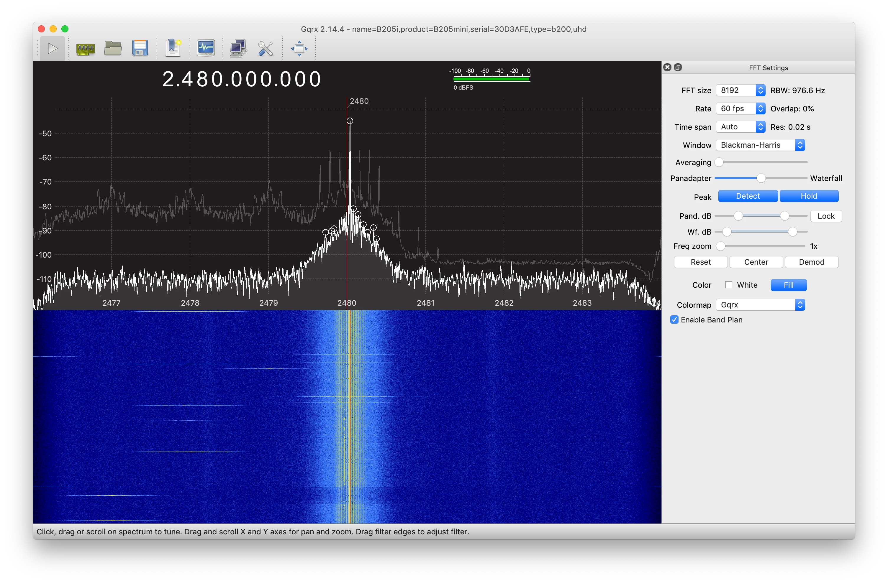

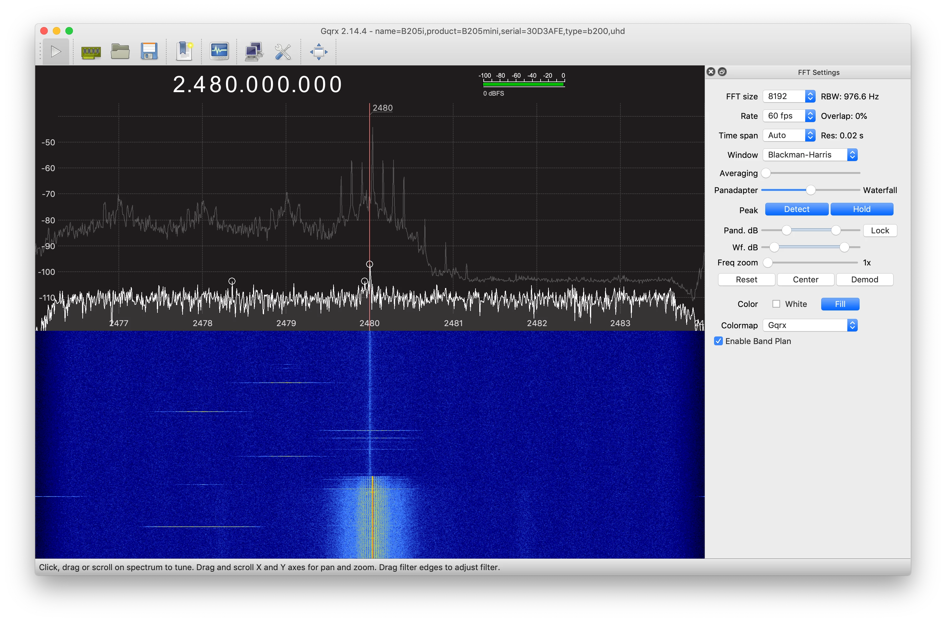

AkuAuthor
Sep 25, 2021 11:59 PM UTC
Those are previous test samples0693W00000FARGzQAP.png0693W00000FARGuQAP.pngThose are new:
0693W00000FARH4QAP.pngPacket test is failed, there is a small spikes after Carrier Test that can be seen, and then silence.
