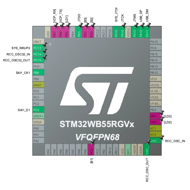

I connected Vdd to 3.3V, GND to GND, select to GND, data to SAI1_D1 (PC3) and clock to SAI1_CK (PB8).

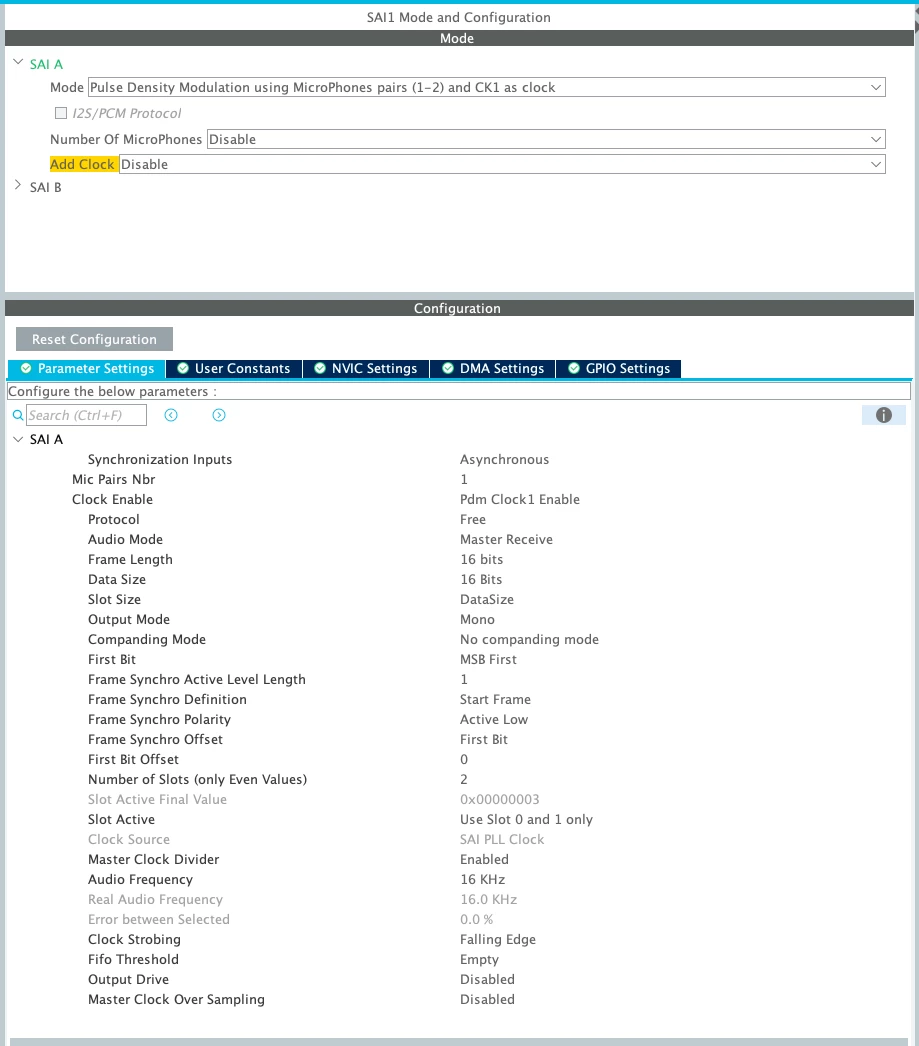

In CubeMX I activated SAI1, set the following options:
  • PDM
  • Mono
  • 16khz (SAI1 clock set to 40.96 MHz)
  • 16bit data/frame

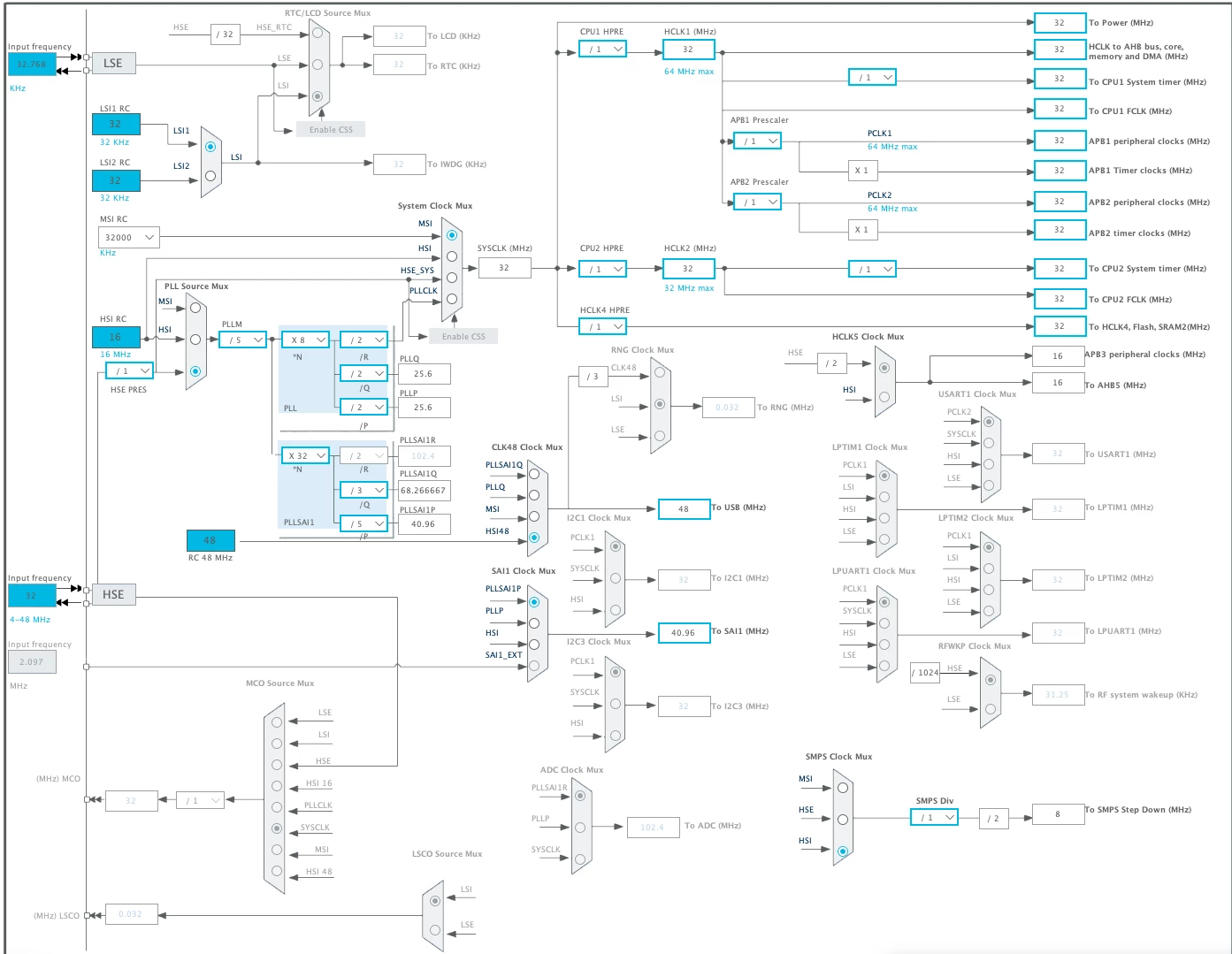

In clock configuration:

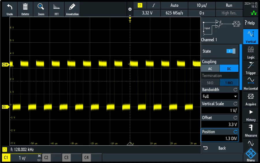

If I probe the SAI1_CK pin (PB8) I see a 128 khz clock. Obviously this is too less and not correct, what am I overseeing here? Maybe a bug?

If I use these clock settings it is almost 1.024 mhz:
And the oscilloscope:
Especially the PLLSAI1R value is important. If I change To SAI1, it seems unpredictable.
