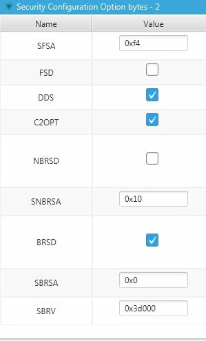

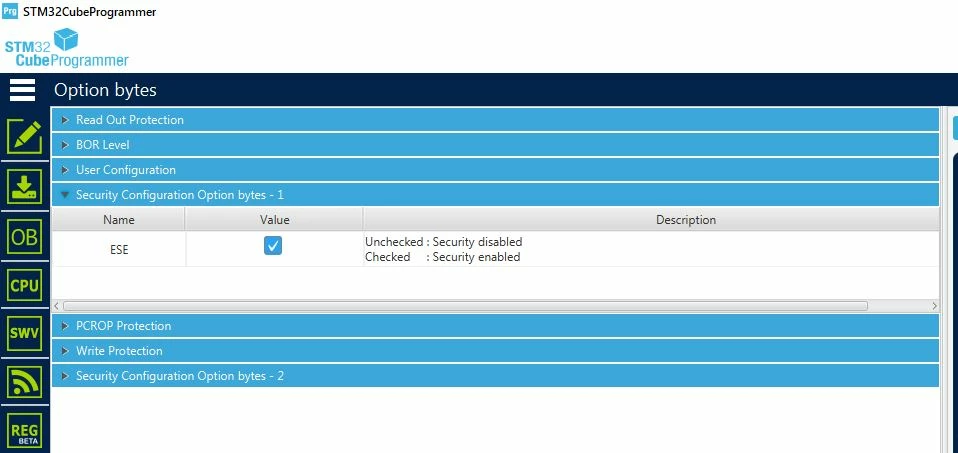

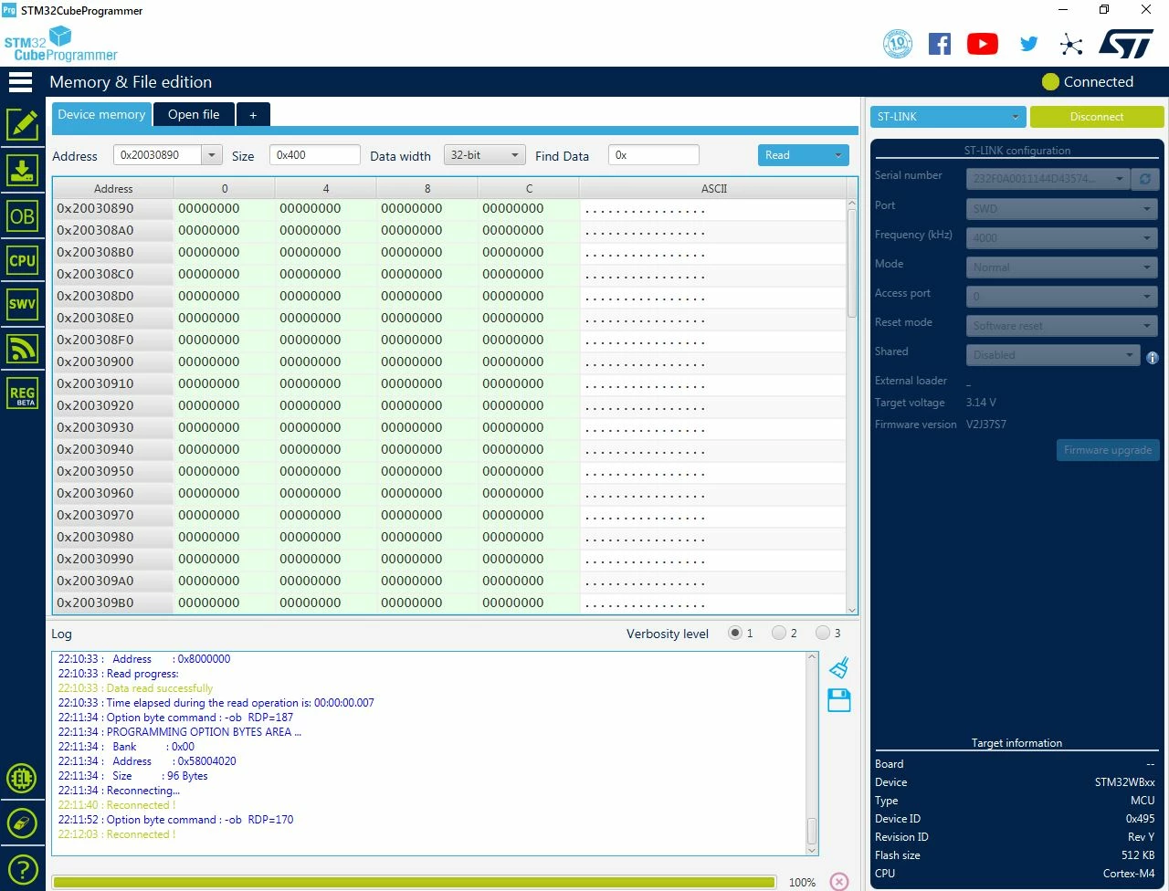

akarp.2161
Dec 25, 2021 8:39 PM UTC
Hi!)
Has the issue been resolved?
I have a similar problem. Previously, I successfully used WB55CGU6 (rev. Y) in my device, now I'm trying WB55CEU6 (rev. Y) (bought in June 2021 on Arrow.com ).
1. I tried to run on 5 boards in USB DFU mode - to no avail. I rechecked the OB combinations several times, physically pin BOOT0 to pull up to Vdd. The USB circuits actually work - I checked using a separate USB Mass Storage Device firmware.
2. When trying to work with FUS via SWD (of course at the changed addresses for CE), I get FUS_STATE_ERR_UNKNOWN errors.
3. Reading RAM at 0x20030890 gives all zeros.
Could these be "special" chips with damaged FUS?)
Help me) Thanks!0693W00000Hpmr3QAB.jpg0693W00000HpmrDQAR.jpg0693W00000Hpmr8QAB.jpg
Remi QUINTIN
Jan 14, 2022 4:50 PM UTC
Before going any further , are you able to know the FW version of the FUS installed on your new boards?
Then Which FUS file do you want to program? Which WB FW version are you using?
 a )Using the USB_USER port in DFU mode, be sure to set the PH3/BOOT0 pin to high and set the nSWBOOT0 option byte to 1 and nBOOT1 option byte to 1. NBOOT0 option byte is not applicable as the Value is set by the external BOOT0 pin. If those options bytes are not set properly, you need to revert to the SWD port to configure them.
Your new board is now having only 512KB flash memory. What is the FW stack to program? Did you check its size?
b) Now using SWD port, it looks like you are able to connect your board. In that case can you check and the FUS version?
akarp.2161
Jan 14, 2022 6:15 PM UTC
1. An attempt to read the status and version of FUS via SWD ends with the error FUS_STATE_ERR_UNKNOWN
At the same time, the data in the first flash sectors changes from 0xFF to some data.
2.I use the FW_WB V1.10.1 version
FUS version: first stm32wb5x_FUS_fw_1_0_2.bin, after - stm32wb5x_FUS_fw.bin from FW_WB V1.10.1. addr: 0x0807A000.
3.I tried USB DFU again - it doesn't work! Under the same conditions on WB55CG - everything is OK
4. I use BLUE_STACK_FULL, ~162kB
