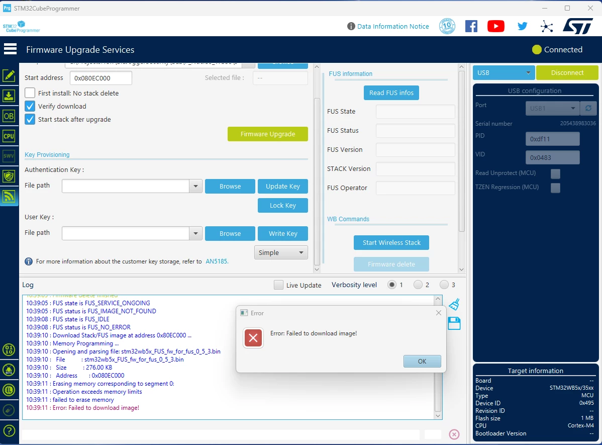

Am now trying to upgrade the FUS in the dongle from .53 to current using stm32wb5x_FUS_fw_for_fus_0_5_3.bin, using 0x080EC000 as listed in Release notes, and it fails.
10:39:11 : Erasing memory corresponding to segment 0:
10:39:11 : Operation exceeds memory limits
10:39:11 : failed to erase memory
Dongle has the STM32WB55CGU6 MCU.
Looks like the start address is wrong, but what should it be and where do I find this info.

However, I just noticed on your screenshot that the FUS file stm32wb5x_FUS_fw_for_fus_0_5_3.bin you are trying to download doesn't have the correct size.
I read Size=276KB, which is too big.
Extract from your screenshot:
Correct size of the file is around 24KB.

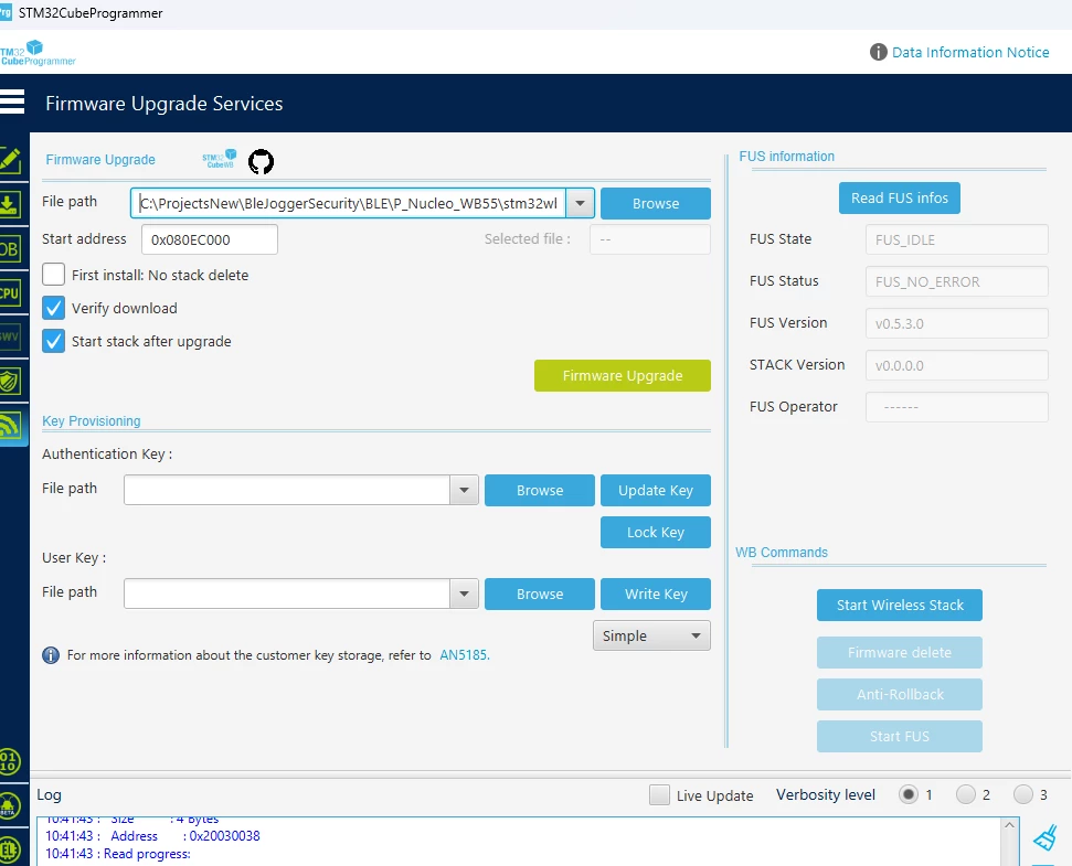

Below the test I have just done on my dongle:
Please, as pointed by my colleague, can you precise exactly where you are getting this stm32wb5x_FUS_fw_for_fus_0_5_3.bin file?

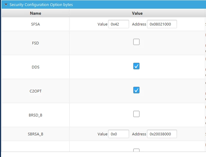

Please, can you share Option Bytes values of your Nucleo dongle?
Specially SFSA, FSD, C2OPT, SBRV (in "Security Configuration Option bytes") and ESE.
It will give us an idea of how the device is configured.

Alan
ESE  -  checked
SFSA  Value=0xF6, Address = 0x080F6000
FSD  -  unchecked
C2OPT - Checked
DDS - Checked
NBRSD Unchecked
SNBRSA: Value=0x19, Addr = 0x2003C000
BRSD - Checked
SBRSA  - Value=0x0, Addr = 0x20030000
SBRV Value=0x3D800, Addr = 0x003D80
Thank you.

Many thanks for the data.
Look like your device is still with FUS v0.5.3
I don't see any corruption, thus from my perspective the device is not damaged.

path for my download is
https://github.com/STMicroelectronics/STM32CubeWB/tree/master/Projects/STM32WB_Copro_Wireless_Binaries/STM32WB5x
Alan - Thanks for bringing up the invalid size.
I was right-clicking and save, versus using the GitHub download.
This caused the bad download.
With the new download I was able to update the dongle.
Thank you much for staying with me on this.
