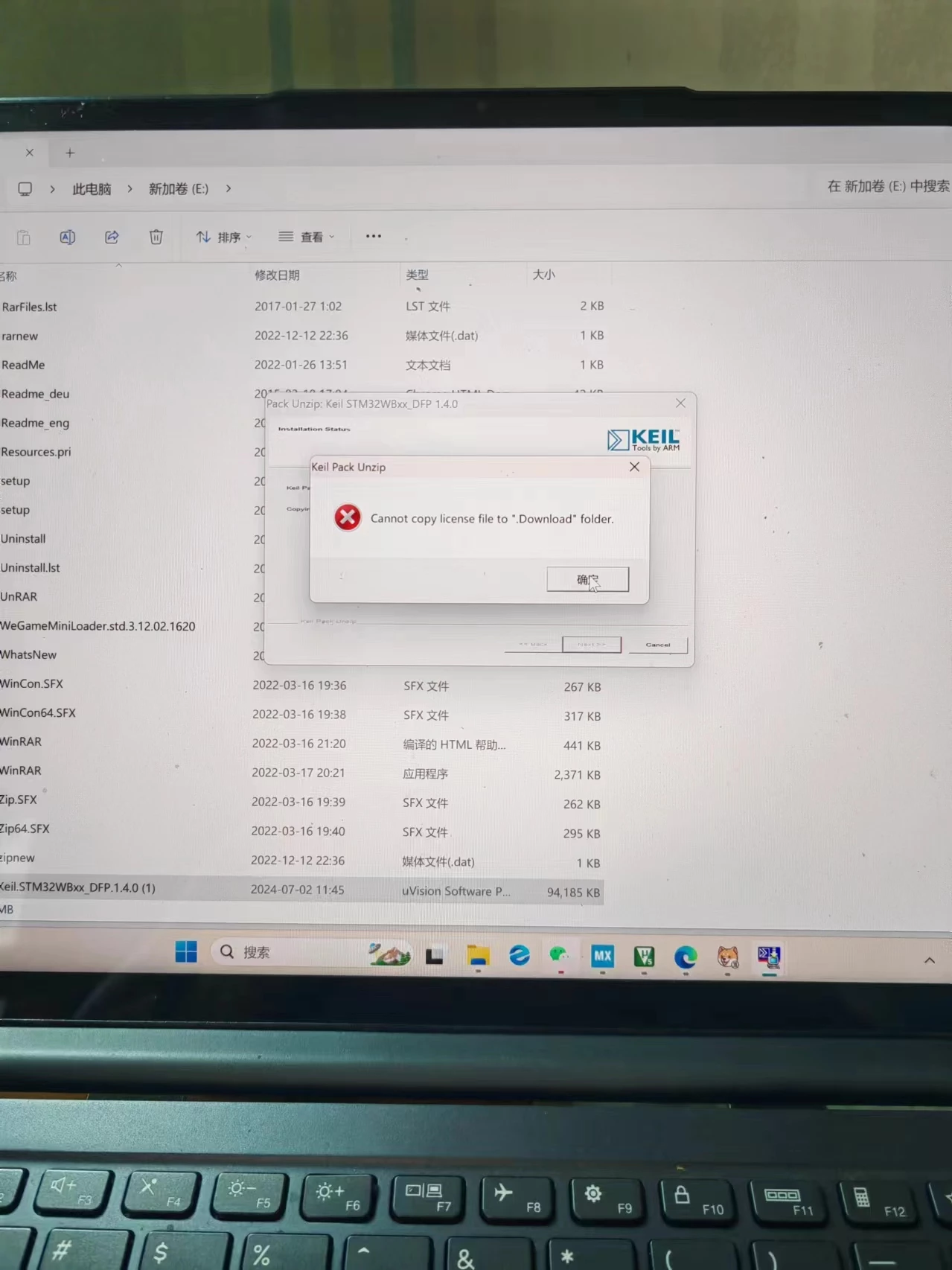

STM32WB55 - Keil Error in Pack Download / Install
The chip package of the STM32WB series in Keil has been failed to be installed, and the display "cannot copy license file to '. Download' folder”756d471d7c6e9918861d03f88a30ec3.jpg

For licensing issues, you need to talk to Keil/ARM:
https://developer.arm.com/support/licensing
https://community.arm.com/support-forums/f/keil-forum

This might relate to how you installed Keil, and where the C:\Keil5\ARM\Packs directory exists.
Things like non-English/Western characters in file names and paths. Spaces in paths. Directories on network, or virtual drives? Microsoft OneDrive ? Desktop ?
A typical working install would have
C:\Keil5\ARM\Packs\.Download
