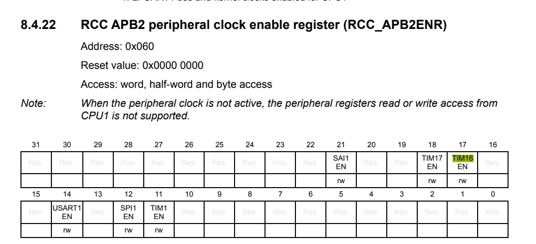

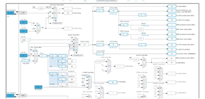

I am using STM32WB55 with 32 MHz HSE and am trying to find out which input clock frequency I should use for TIM16. Unfortunately it is not clear in the diagram from the datasheet. Where can I get this information?

    Hello @AndreasC and welcome to the ST Community :smiling_face_with_smiling_eyes:.
    the APB2 is the clock bus for the TIM16:

    You could save yourself this answer ;) It is not clear to me which clock bus the TIM16 is on (APB1 | APB" etc.) ...
