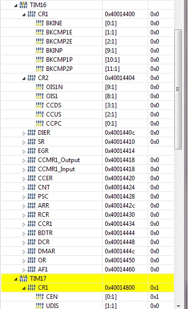

I enable counter by __HAL_TIM_ENABLE(&htim17);
and I see in debugger that PSC register incrementing, not CNT. CNT is always zero. Are the registers messed up?
Settings are from CubeIDE 1.41 with stm32wb pack 1.8:

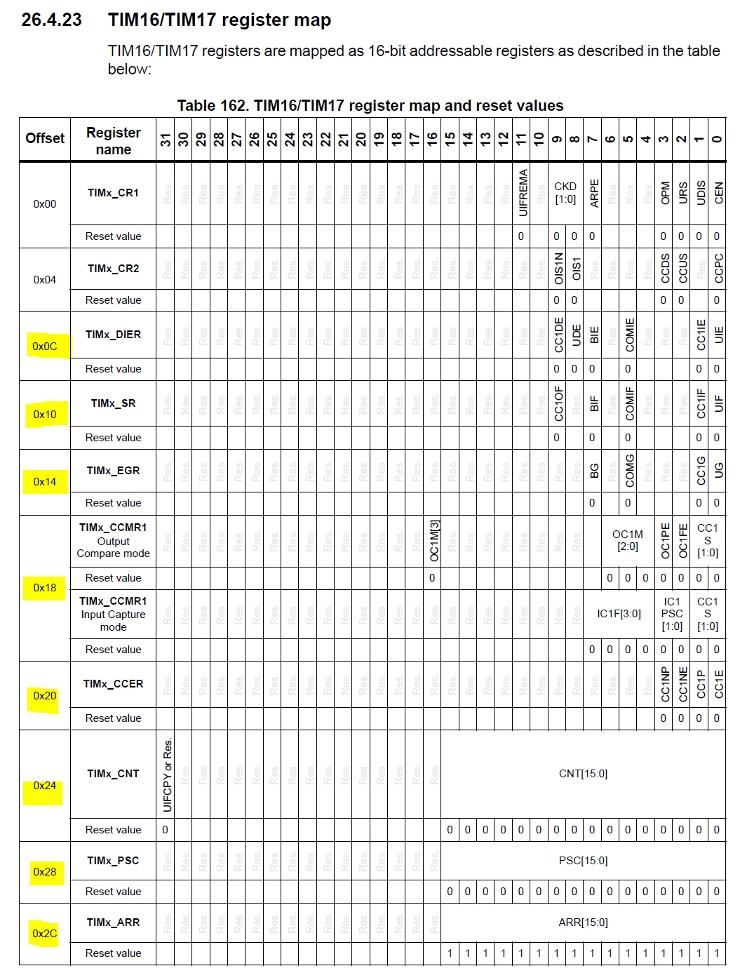

It appears the SVD file is incorrect on quite a few of the registers. The error starts at DIER which should be at 0x0C.
dungeonlords789
Aug 1, 2020 10:34 PM UTC
If @TDK​ 's table is for Tim16 and Tim17, then TIM16 looks strange, isn't it? Where is CEN bit of CR1 in TIM16?0693W000003BtHQQA0.png
Aug 1, 2020 10:52 PM UTC
It's bit 0 of CR1, right there in the table. Seems fine to me.
Edit: Oh, now I understand.
Agreed, CEN is missing in the SVD file as well (but the table seems correct).

I did check for you and unfortunately some address Offset for the TIM17 are incorrect which explains the seen behavior. Also TIM16 should have same fields description as TIM17 to be aligned with RM.
We fixed this in our SVD fies. Let me know If you are interested in the updated SVD file with the fix so I can attach it.

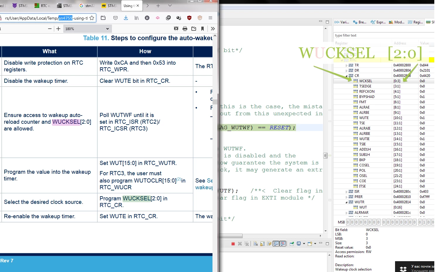

@Imen Ezzine​  Did you fix SVD in 1.9.0 pack? I can no see Patch tab in 1.9.0. This is also another bug about WB55 systick problem https://community.st.com/s/question/0D50X0000B8hnwCSQQ/stm32wb55-haldelay-function0693W0000059U9VQAU.png

Also check RTC registers!
