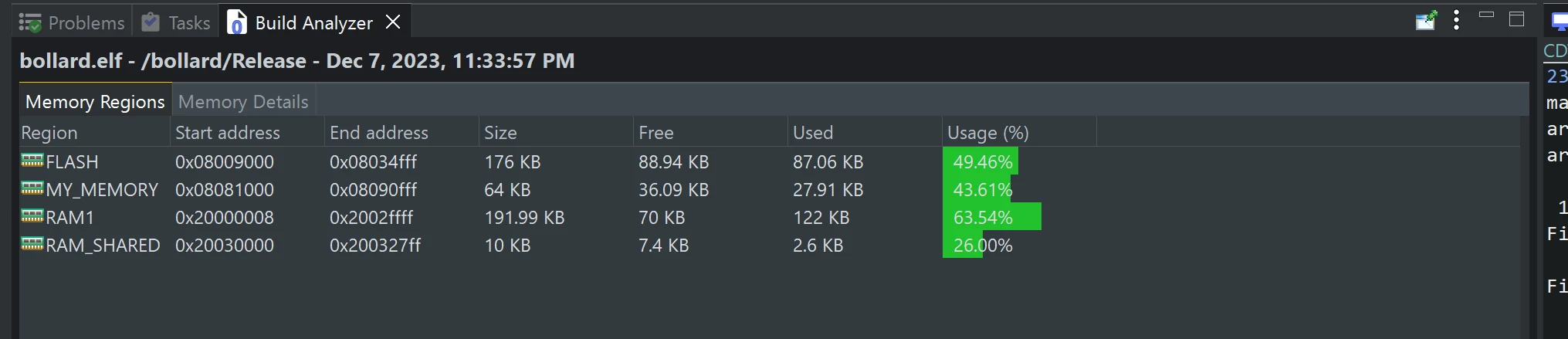

(STM32WB55) Generated Binary is too large. Expected <100kB but get >500kB.
I have added a partition (MY_MEMORY) to my flash to store a static library (littlefs) so that I don't have to include it in the firmware that is updated over the air however the output binary file for the project is very large. I have reviewed this post which describes a similar problem however the given solution has not worked in my case.

TomC
TomCBest answer
Senior
Dec 10, 2023 7:49 PM UTC
Thanks for your response TDK. I ended up getting around the problem by first loading the micro with the binary that was generated with the linker script below. This binary loads LittleFS to 0x08081000 and will be about 20kB larger because of it.
 .API_SHARED 0x08081000:
 . = ALIGN(4);
	*(.text.lfs*)
	*(.text.add)
	. = ALIGN(4);
 } > MY_MEMORY
Then when I generate the firmware that will be updated with OTA I use the linker script below which contains the keyword NOLOAD. This binary will look to 0x08081000 for LittleFS functions but not actually compile any LittleFS code, meaning the generated OTA binary is smaller.
 .API_SHARED 0x08081000 (NOLOAD):
 . = ALIGN(4);
	*(.text.lfs*)
	*(.text.add)
	. = ALIGN(4);
 } > MY_MEMORY

Your addresses seem a little off, although I don't know that MCU:
FLASH (rx) : ORIGIN = 0x08009000, LENGTH = 176K
MY_MEMORY (rx)	 : ORIGIN = 0x08081000, LENGTH = 64K
 FLASH starts at 0x08009000, and MY_MEMORY 0x08081000, which is a difference of about 500k...
TomC
TomCAuthor
Senior
Dec 10, 2023 7:50 PM UTC
Hi LCE thank you for your response, indeed as you say the addresses are non-standard due to the inclusion of a bootloader at 0x0800000 and some firmware staging slots between 0x08009000 and 0x08081000.
Dec 7, 2023 2:02 PM UTC
BIN files aren't able to store data from separate places like this without filling in the data between them. Use a HEX or ELF file, or create a separate BIN file for each memory section.
