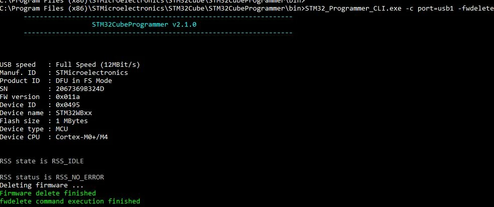

  • STEP 3 : Delete current wireless stack :
    • STM32_Programmer_CLI.exe -c port=usb1 -fwdelete

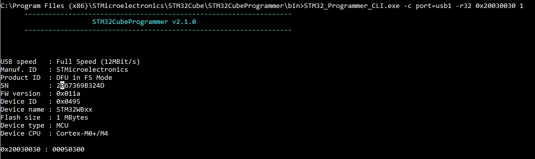

STEP 4 : Read and upgrade FUS Version
  • STM32_Programmer_CLI.exe -c port=usb1 -r32 0x20030030 1
    • 0x20030030 : 00050300 : FUSv0.5.3 => Must be updated using STEP 5.
    • 0x20030030 : 01000100 or 01000200 : FUSv1.0.x => Up to date, you can download the new wireless stack using STEP6.

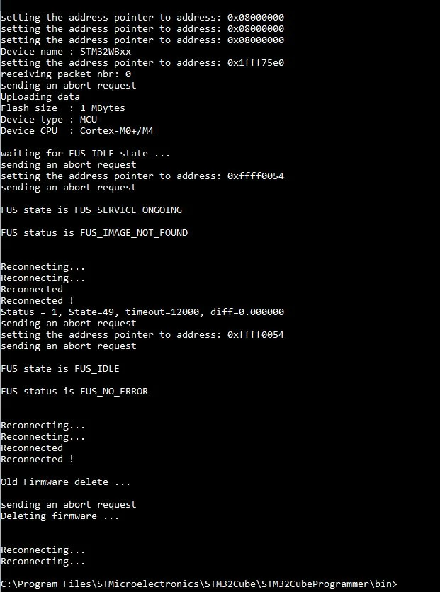

STEP 5 : Download new FUS :
  • STM32_Programmer_CLI.exe -c port=usb1 -fwupgrade [FUS_Binary] [Install@] firstinstall=0
in my case
STM32_Programmer_CLI.exe -c port=usb1 -vb 2 -fwupgrade stm32wb5x_FUS_fw.bin 0x080EC000 firstinstall=0
I increse the verbose mode to 2 (I join the log file flash_FUS_VB2)
most of the time the upgrade fail during the reconnecting process after Deleting firmware...0690X00000AqiduQAB.jpg
if this part pass I have a firmware not authentic at the end
Reconnecting...
Reconnected
Reconnected !
sending an abort request
setting the address pointer to address: 0xffff0054
FUS state is FUS_UPGRADE_ONGOING
FUS status is FUS_IMAGE_NOT_AUTHENTIC
Error: Firmware not authentic!
and obviously because of this I can't upload the BLE stack.
