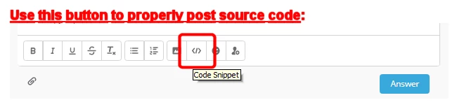

@Sean Park​ - even ST Employees don't know how to properly post source code to their own forum? :\
Sean Park
Jul 12, 2022 8:52 AM UTC
I'm sorry. thanks for pointing out
