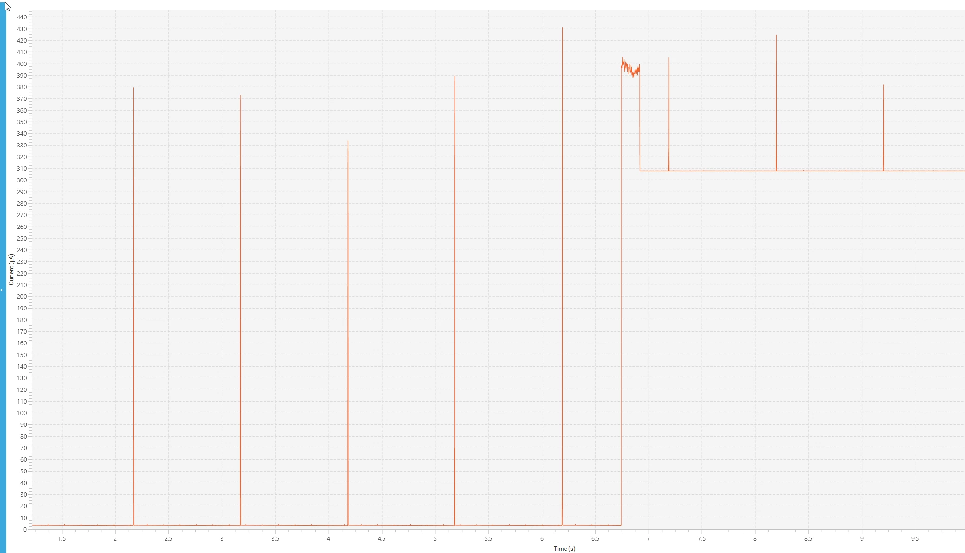

Jun 27, 2024 12:23 PM UTC
There shouldn't be any issue in this regard.
I'd suggest starting from one of the BLE examples. E.g. here I'm using the BLE_Beacon project. By default, the user buttons are set so that I can wake up the MCU and I added a simple code to switch between STOP and SLEEP modes. This is the resulting power consumption.
Jun 27, 2024 6:01 PM UTC
Even in ST´s video, using EXTI on STM32WB55 is not recommended, why is that? https://www.youtube.com/watch?v=Zgw3wRpGSRQ&list=PLnMKNibPkDnG9JRe2fbOOpVpWY7E4WbJ-&index=17
I got the low power with EXTI working by resetting the power for the board after uploading firmware, resetting the MCU was for some reason not enough. Now I am getting the same current consumption as with the timerserver setting the task.

EPASZ.1Best answer
Jun 28, 2024 6:30 AM UTC
If by 'not recommended', you are referring to the slide ~ 2:40, then this clearly concerns only stack functions like the aci_gat... function shown there. Otherwise, you'd be sending multiple (maybe contradicting) commands to the stack. Other generic code can be executed here without issues. It just should be kept as short as possible - this is true in general for interrupts.
From an interrupt, the code returns to the place where it was interrupted - so in this case, it would be to the active task which was run before the interrupt.
