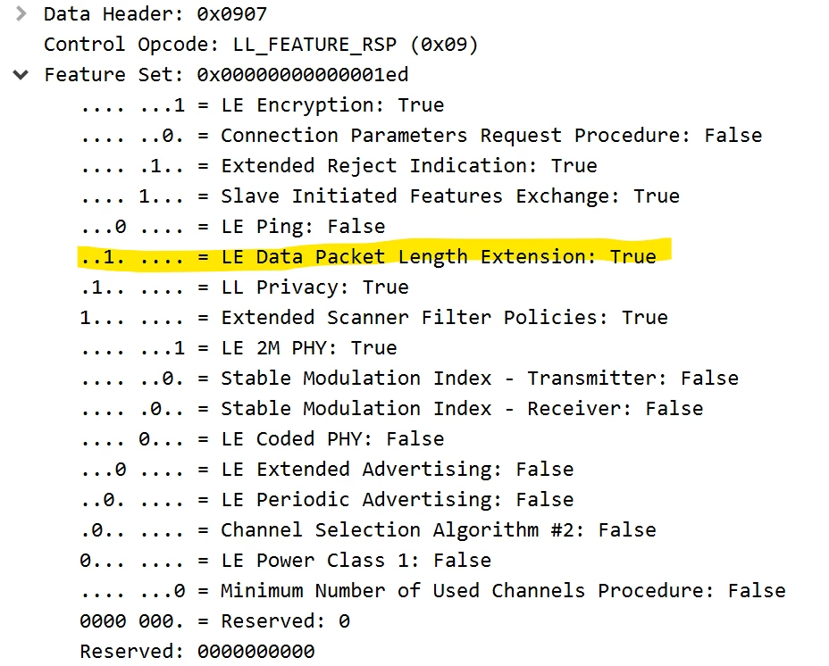

But in the air trace I see two things that make me think that DLE is enabled even with the configuration that should disable it.
1) In the LL_FEATURE_RSP that comes from the STM32WB we see that it tels us that it supports DLE:

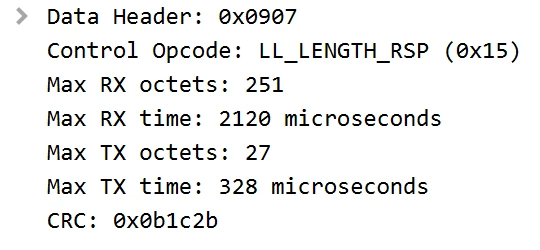

0693W00000SwAe9QAF.png2) In a response to a LL_LENGTH_REQ we get a nomal response with an extended RX length:
0693W00000SwAeTQAV.pngIs this a normal behavior? I would expect that the DLE feature is not activated and the LL_LENGTH_REQ is rejected.

I observed the very same thing, and I am really curious to know why the CFG_BLE_DATA_LENGTH_EXTENSION has no effect.
